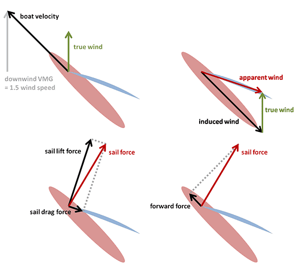

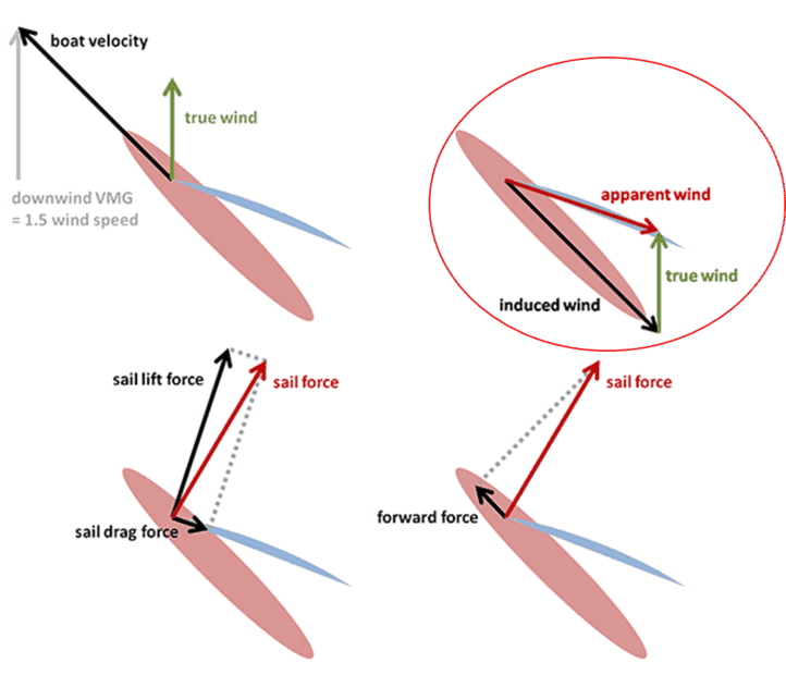

A.T. said:
The proof that it works is neither the animation nor math, but racing boats which do it for years (ice boats for a century). The animation just shows how trivial it is.

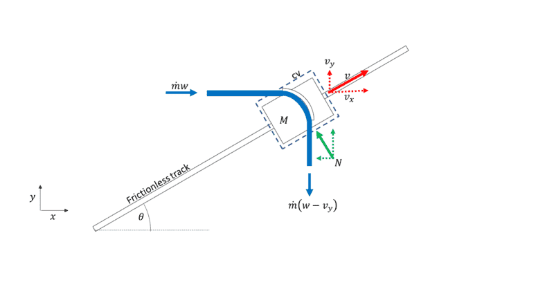

erobz said:
What is the maximum velocity of the cart in the following image?
Same as for a boat with a fixed sail going directly downwind. But the boats that achieve downwind components greater than windspeed are not going directly downwind. Your original model was more relevant, just your sail model was bad.
Mathematical rigor is useless, if in order to formulate / solve your math, you have to make assumptions which completely change the scenario. I recommend using vectors in this case (see post #21).

erobz said:
I've shown it with Newtons laws, Eulers, and Reynolds laws twice now for two independent sail configurations.
But neither one of your configurations corresponds to a boat with downwind component greater than windspeed.
Go back to your first one, but rotate the sail by 90° clockwise. What happens when Vx = W? Can you still accelerate?

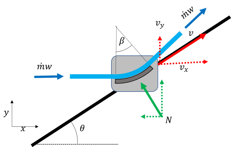

No it can not accelerate. The mass flowrate ##\dot m = \rho A (w-v_x)## entering the control volume always goes to ##0## as ##v_x \to w##. The fluid jet can only just keep up with the cart, it can no longer impart any further momentum to it. If your hope was that the momentum outflow changes to ##\dot m (v_y +w)##, sorry ##\dot m \to 0 ##.

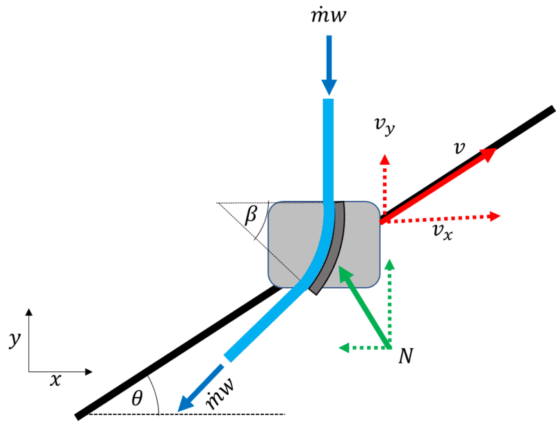

erobz said:
No it can not accelerate. The mass flowrate entering the control volume always goes to ##0## as ##v_x \to w##.
You think there is no relative wind at the boat when Vx = W? Think again, what about Vy?

Nope. Look at the vectors. If true_wind = 0 then apparent_wind = -boat_velocity. So even a infinite lift/drag ratio won't produce a forward_force. The sail_force can be at most 90° from the apparent_wind.

erobz said:
If I am running with speed ##w## behind a car at speed ##w## holding a bag of rocks, I can't simply smash out the rear window by simply letting a rock go..
If the car additionally has a velocity component perpendicular to w (like the boat in your model below) then you can smash a side window by just letting the rocks go.
Or alternatively the car passengers can use a surface to deflect your rocks, and get some propulsion from that (for this the sail in your model needs to be turned by 90° clockwise)
