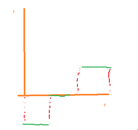

The figure shows a metal coil labored as A. Heading torwards a region where a uniform static magnet field exists, poiting torwards the ground (hence X). The coil moves with the same constant velocity. As it enter the magnet field the coil will have an induced current in it. After a while A leaves the magnet field. Draw a I-T graph showing this scenario.

My thoughts. When the coil enter the magnetic field, there will be an induced current that is counterclockwise. When it leaves the magnetic field there will be an induced current that is clockwise. Inbetween there is no current, or is it just constant inbetween? My guess would be that the current is 0 when it dosent leave or enter the magnetic field but I don't know.
So to my questions:
1. How should i know whether the graph should be constant or linear?
2. Is the current counterclockwise a.k.a negative when it enters and clockwise a.k.a positive when it leaves?
3. Is the current 0 inbetween or not?

For question 3, think about whether or not the flux through the coil is changing once it is completely inside the field region.
http://imgur.com/a/czmiF
Yes the FLux is not changing when its inside, hence the current should be 0?
How about question 2 and how should i start the graph?

Right, the flux through the coil is not changing once the coil is completely inside. Can you fill in the argument for why this implies that the current should be zero?

You listed Faraday's law e = -dΦ/dt in your first post. (For a coil of N turns, this would read e = -NdΦ/dt.) This is the key equation for deciding how the emf e changes with time. I recommend that you first tsketch a graph of the flux Φ as a function of time. Let t = 0 be the time that the front edge of the coil starts to enter the field region. Due to the square shape of the coil, how does the flux increase with time? Linearly or something else?
From this graph of Φ vs t, you can then see how dΦ/dt depends on time.
2. The I is 0 coz the flux dosent change thus the emf is 0 and that means no current?
Yes, that's good.

So this is how i think.
1. The Magnetic flux increases linerarly since A has the shape of a Square. (when A enter)
2. Inside the Flux won't change.
3. When it leaves. the flux decreases linearly
First of all. IM here very unsure if the word "increase" and "decrease" is correct in 1 and 3. Second of all. Since it has the shape of a square, is it the only reason why it would be linear or is there a more mathematical or physical way to explain why the Flux is linear here.
4. If Flux is linear. e will be a constant . And since e=R*I the I will also be constant, No R is given.
(Third of all, this sounds a bit farfetched, is it the only reason why e and I is constant)?
5. The current will be counter-clockwise at the start. Let's call that negative.
6. The current will be clockwise when it leaves. Let's call that positive. Thus the graph is something like this
Fourth of all, should i keep the "red dotted lines"
Fifth of all, is it close to a correct graph?

Good
Assuming you take flux into the page as positive, then it should be clear that the flux is increasing in 1 and decreasing in 3.
Suppose it takes 0.6 seconds for the square to completely enter the field. Sketch pictures of the location of the square at each 0.1 second. You should be able to see that the flux increases by the same amount during each 0.1 s. Repeat for a circular shape to see a case where this is not true.
This is correct.
The reason e is constant is because the flux increases or decreases proportional to time for the square shape. The reason I is constant is I = e/R.
OK
The dotted lines are optional in my opinion, it's OK to keep them. Your graph is pretty good. You could improve it by adjusting the relative widths of the three parts to be more accurate.
