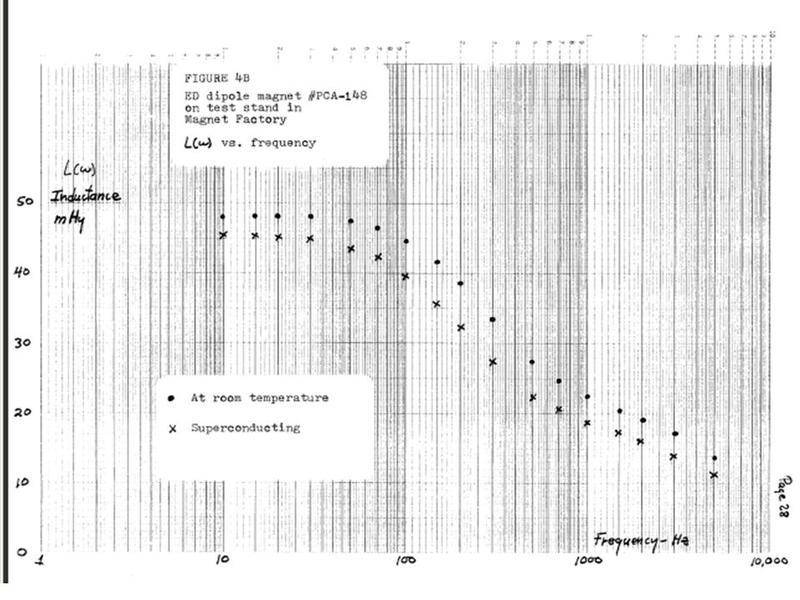

The attached thumbnail shows inductance measurements made on a 7-meter long superconducting magnet used in the Fermilab Tevatron. The frequency range covers 10 Hz to 5000 Hz. The two sets of points were made at room temperature (top points) and at 4.2 kelvin (bottom points). The ≈ 3 mH difference in inductance is due to the magnetic flux exclusion from the superconducting coil in the magnet.
AC loss measurements were made at the same time as the inductance measurements, and they were the same; no change from room temperature to superconducting. The loss of inductance in both measurements at frequencies above ≈ 50 Hz were due to eddy currents in the non-magnetic stainless steel cryostat.
