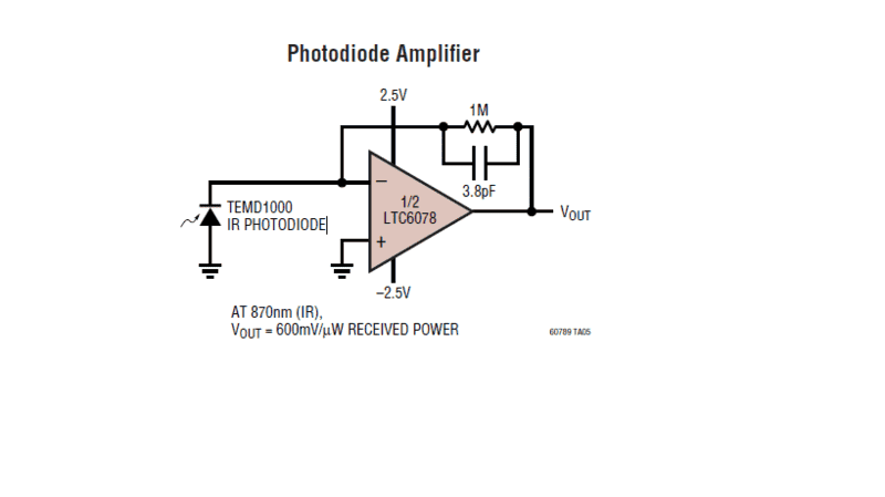

Hi everyone. I need small help regarding my BE project. I would like to design a current to voltage converter circuit for silicon detector, which produces current of 10pA. can anyone help me how to start please.

For this, look into electronmeter amplifier. They are mostly transimpedance amplifiers.
go to Analog Devices page and look for op-amp with low bias current in 200fA max. Look for application notes and study it. This is a bigger subject than you might think and it is impractical to explain in a post. Do some study and we can talk a lot more on the requirements you need.
If you have more specific question, post back. Get some knowledge first.

During the study i have found this op amp (LTC6079CGN#PBF). It has input bias current of 1pA. I am attaching my circuit diagram and link. Can some one please check and give me some suggestions (http://www.farnell.com/datasheets/62514.pdf).

1pA bias current is high for OP. He/she need to detect 10pA. The feedback resistor is in the range of 1GΩ to get 10mV from 10pA. Here are threads that I had discussion on this topic:

For this low current, it is not that simple anymore. Vibration can be a big problem on top of noise, offset, drift and settling. OP has to study up electronmeter amplifier before any meaningful discussion.
Hi yungman. My teacher suggest me to use TL072IN op amp. Now i want to simulate this circuit in mindi or Ltspice but i couldn't able to find any predefined model. I have tried in internet, I found this link (http://www.madlabo.com/mad/edat/spice/model/opamp/Tl072.mod ).
can you please suggest some comments.
You need to clarify your first post. You said you want to detect 10pA. Input bias current of TL072 is over 65pA and offset current is high. If you truly want to read 10pA with any accuracy, you cannot use this. Not even close. You need to specify more on what are you trying to read. Specification like:
