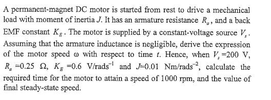

I try to derive the expression of ω with respect to t,
but the problem is the armature current Ia or the flux is unknown. I don't know how to solve it.
Anyone could give me ideas? Thanks a lot
τ=J(ω/t)
Vs=IaRa+Ea
T=KEøIa
Ea=KEøω
  • Typed problem statement on a permanent-magnet DC motor with armature resistance Ra = 0.25 ohm, back EMF constant KE = 0.6 V/rad/s, inertia J = 0.01 Nm/rad/s², and source Vs = 200 V, asking for the speed-time expression and time to reach 1000 rpm.
Either (a) you are mistaken, and there is some way to find Ia, or (b) you can make a substitution for Ia so the term no longer appears in the equation - like you do with simultaneous equations.

Thanks for your reply.
I did in the following steps:
1.J(ω/t)=KøIa;
2. and then substitute Ia from Vs=IaRa+Ea into 1;
finally, i got:
ω=Vs/(Kø+JRa/Køt)
But it turns out the term ø cannot be eliminated and it is unknown.
Where am i wrong?

Really?
What physical property does "ø" represent?
τ=J(ω/t)
... isn't that supposed to be: $$\tau=J\frac{d\omega}{dt}$$...??
ω=Vs/(Kø+JRa/Køt)
recheck your algebra there...
how did you get this from what went before?
The fact they give you a bunch of initial values suggests to me you should look for a DE.
ø is the magnetic flux.
i have double checked for it, the deriving process should be right.
and it seems reasonable if t approaches infinity
Vs=Køω quite similar to Ea=Køω
Derivation:
... So long as you are sure.
You don't appear to have used the fact that the armature resistance is "negligible".
What does that do to the derivation?
