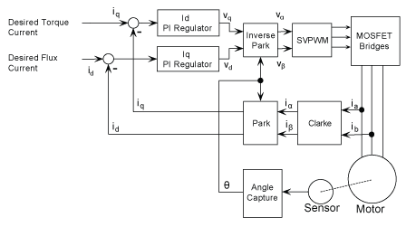

essenmein said:
No grid here! I control the frequency.
I don't understand. Are you running with a resistive load? Is there a speed governor? How are you controlling the frequency?
All of the machines I've worked with are inverter driven... Traction drives/hybrid etc.
More or less this general topology:
