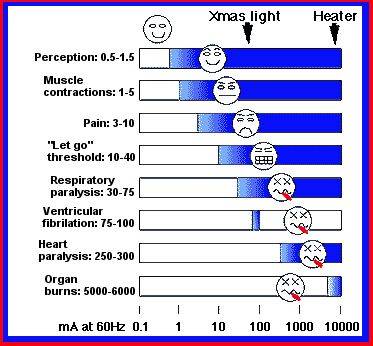

Voltage by itself is not particularly harmful. I could expose you to 10,000,000 volts and under the right conditions you will experience no ill effects and feel nothing. Current and duration must also be considered. The following chart addresses current...

Voltage is relevant in that it is the electrical pressure which causes current to flow. Ohms law states that I=V/R where I is current, V is voltage, and R is resistance. If a particular path through your body is 10,000 ohms then 1 volt will result in a current flow of .0001 amperes, that is not enough to even feel. You can also compute the amount of electrical power being dissipated by your body by multiplying the volts by the amperes, in this case it is 0.0001 watts. Now if 100 volts was applied to the same path it would result in a current flow of .01 amperes. According the the chart that's enough to be painful. Power flow in this case would be 1 watt. 10,000 times the first scenario. So you can see that power flow through your body will increase with the square of voltage.

It explains pretty much exactly what you said. So I guess as a general rule, assume the resistance of the body is R = 1500 Ω. Then, find the current by the voltage employed, and reference this to that chart?

So the numbers on the bottom (in the log scale) are current in mA? What, then are the numbers on the left-hand side of each bar? What do the shaded areas represent?
