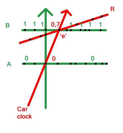

Good job, Darwin. I would like to elaborate on this.
It made me think more specifically about the layman's definition of a world (everything that happens simultaneously at a specific moment in time)...
What you call 'in' a reference frame, I would rather call this 'part' of a world.
Let me explain this.
When I first learned about SR I interpreted the reference frame as a 'the world of simultaneous events at a specific time', but strictly spoken that's not correct if one considers that a moving object 'in' that reference frame' is not 'part' of that reference frame. However, the event of the moving object that is 'in', but not 'part' of my reference frame is indeed part of my world of simultaneous events at that moment !
A diagram shows this better:
154271[/ATTACH]"]
Event 'e' (car clock physically on 0,7) is in a green reference frame, but is not part of that reference frame.
However, event 'e' is part of the green world B ! And event 'e' is also part of red world R.
The O,7 car is definitely part of my green world of sim events. And the car clock ticks slow in my world relative to my reference frame. But the car clock is not part of my reference frame. The O,7 car clock is not slower in the green reference frame, but rather relative to my green reference frame.
Of course the car driver will have a similar but different story to tell... ;)
V.

  • #52
I really do not understand why you guys are still debating this topic. My post with diagram shows and explains it all.
