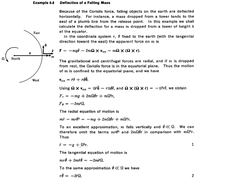

Because of the Coriolis force, falling objects on the Earth are deflected
horizontally. For instance, a mass dropped from a tower lands to the
east of a plumb line from the release point. In this example we shall
calculate the deflection of a mass m dropped from a tower of height h
at the Equator.
I have attached the example for your convenience, But I want to solve it on my own with your help.
3. The Attempt at a Solution
Does it matter whether I consider any point on the Earth or equator?

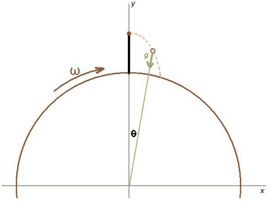

Wrt. inertial frame,
Taking cylindrical coordinate system whose origin coincides with the center of the Earth and the +ve z- axis is along the axis of the rotation of the Earth,
Let's say that the equator is rotating with angular speed ##\omega \hat z##. As long as the mass m is in contact with the tower, it's also rotating with angular velocity ## \omega\hat z##.
Let's say that when the mass leaves the tower its velocity is ## \vec v = \omega \left (R + h \right )\hat x ##.
Taking h<< R ,where R is the radius of the earth, the net physical force acting on the mass is ##\vec F_{ph} = m \vec g ##
So, the information I have is:
Net external physical force acting on the system i.e. ## \vec F_{ph} = m \vec g##
Initial position of the system i.e.## \vec r_i = \left ( R+ h \right )\hat y ##
Magnitude of the final position of the system i.e. ## r_f = R##
Initial velocity of the system i.e. ## \vec v_i = \omega \left ( R+h \right )\hat x ##
I have to solve##\vec r ##(t). This will tell me the time when the mass reaches the Earth's surface.
Then, I will have to calculate the final position of the point A i.e. ## \vec r_{Af} = \left (R, \omega t , 0 \right ) ##
By comparing the final positions of A and the mass, I have to show the deflection.

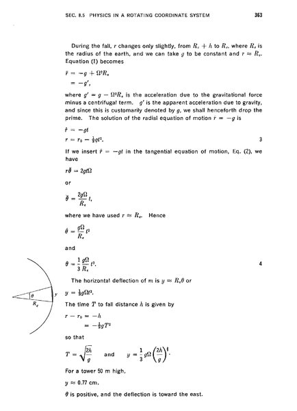

I believe the correct answer is 2/3 of the result that Pushoam got for d in post #9. She introduced an inertial frame with origin at the center of the Earth as shown below
As the object falls, there is a non-constant, negative x-component of acceleration, ##g_x##, of the object relative to this inertial frame. (The axes are non-rotating.)
The 2/3 correction factor is due to ##g_x##.
Using rotating frame of reference, there is the Coriolis force, perpendicular to the velocity of the falling object. We can use a local Cartesian frame of reference, as the high of the tower is very small with respect to the size of Earth. There are then two inertial forces acting on the ball: the vertical centrifugal force, but it can be ignored with respect to mg, and the Coriolis force perpendicular to the velocity: ##\vec Fc=-2m\vec v\times \vec Ω##. As this is a small force, the horizontal component of velocity is small, so we take the direction of Fc horizontal. Let be the vertical velocity v=gt, then the horizontal acceleration is ##\ddot x = 2vΩ =2Ωgt##. Integrating twice and substituting ##\sqrt{2h/g}## for the time, we get the deflection. The factor 2/3 is there.
Likes Pushoam
The physical force acting on the mass is ##\vec F_{ph} = m\vec g = mg \left ( - \hat r = - \sin\theta \hat x - \cos \theta \hat y \right ) ##
Since h<<R, I approximate ##\theta ## to ##\omega t##, ##\cos \theta ## to 1 and ## \sin\theta ## to ##\theta ##.
Considering motion in y- direction,
-g = ##\ddot y##
##\dot y = -gt ## as at t =0, vyi = 0
##y = -\frac 1 2 g t^2 ##
## -h = -\frac 1 2 g t^2 ##
## t = \sqrt {\frac {2h} g } ##
Considering motion in x - direction,
##\ddot x = -g\omega t##
##\dot x = \frac {-g\omega t^2} 2 + \{\dot x_i = \omega \left( R+h\right) \} ##
##x= \frac {-g\omega t^3} 6 + \omega \left( R+h\right) t ~as~ x_i = 0 ##
So, horizontal distance traveled by the mass ##x_m = \left (\frac {-\omega h } 3 + \omega \left( R+h\right)\right ) t ##
horizontal distance traveled by the Earth ## x_E = \omega Rt ##
deflection ## D = x_m - x_E = \left (\{\frac {-\omega h } 3 + \omega h \right ) t = \frac {2\omega h } 3 t = \frac {2\omega h } 3 \sqrt {\frac {2h} g }##
Is this correct?

Yes. Nice. Agrees with the standard Coriolis force method as outlined by ehild.
Will you please tell me name of the software which you used for drawing the diagram?
Microsoft Paint.

There is a sign error in the first term on the right side of the second equation.
And ##\vec a_n = g\left( -\hat r \right ) ## , ##\vec v_n = \omega h \hat x + v_r\left (-\hat r\right ) ##
I don't understand either of these two equations.
##\vec a_n \neq g\left( -\hat r \right ) ## in the rotating frame of the earth. ##\vec a_n## is given by your previous equation (after correcting the sign error).
##\vec v_n \neq \omega h \hat x + v_r\left (-\hat r\right ) ##. In the rotating frame of the earth, the object has zero initial velocity. It might help to make a rough sketch of the shape of the trajectory of the object in the rotating frame.
##\vec a_n = \{g- \omega ^2 r\} \left (- \hat r \right ) - 2 \vec \omega \times\vec v_n##
TSny said:
##\vec a_n ≠ g\left( -\hat r \right )## in the rotating frame of the earth.
Why is it so? Won,t a person sitting on the Earth's surface will feel that the mass is coming down with acc. g?
The object is moving with velocity ## \omega\left(R+h \right)\hat x ## and A is moving with ##\omega R\hat x ## wrt inertial frame. So, won't the object has an initial velocity ##\omega h \hat x ## wrt the Earth's frame?
No. If that were true, then the object would not have any horizontal deflection relative to the Earth as it falls.
Yes.
No. The xyz axes of the Earth's frame rotate with the earth. So, before the object is released, the object maintains constant values of x, y, and z. Therefore, the rate of change of these coordinates is zero at the instant the object is released.
