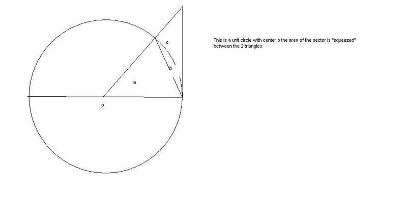

triangles
It is usually done without calculus. Just because it is used to define the derivatives of certain functions. If you compare the areas in the graph you can come up with the inequalities and use the squeeze theorem. Probably works out to the same formula above, but with a little more motivation.:bugeye:
sorry, forgot the picture. Sorry it's not very "pretty"
