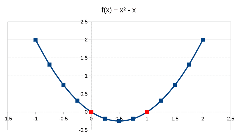

The following is a quadratic equation: ##x^2-x=0##
It has 2 solutions: ##x= 1## and ##x= 0##. It doesn't mean ##1=0##, it just means those two values give the same result in the [arbitrary] equation you stated. Graphic solution:
