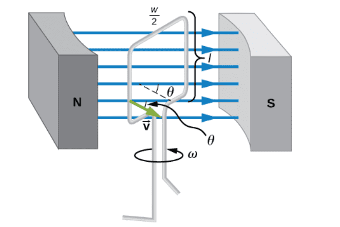

##\phi_m = Blwcos\theta##
voltage = ##\frac{-d\phi_m}{dt} = Blwsin\theta\frac{d\theta}{dt}## where l is the length of the loop and w is the width of the loop
The top and bottom of the loop have magnetic forces perpendicular to the loop. My book says that means that there is no current through it. I do not understand why there is no current through it if the magnetic force is perpendicular to it? ## d\vec F = I\vec dl \times B##
Diagram of a rectangular wire loop rotating about a vertical axis between the N and S poles of a magnet, with parallel blue field lines pointing from N to S; labels show width w/2, length l, angle θ, velocity v and angular velocity ω.
Is it because ##~sin\theta~~## is equal to zero ?

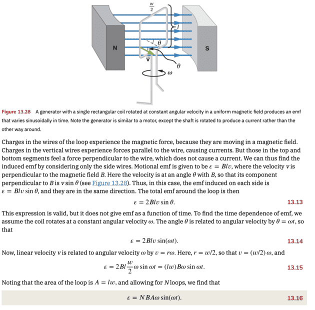

I can't understand either, can you please post an image with the quoted text from the book

Diagram of a generator with a single rectangular coil rotating at angular velocity omega between N and S magnetic pole faces, with field lines drawn horizontally; labels w/2, l, theta, v and omega are shown.

I don't see how it is ##sin\theta## = 0. What is ##\theta## the angle between of?
Yes well, it is one of those passages in a book that can be interpreted totally wrong by a student. Hold on while I try to explain to you what your book really means.
Your book calls "current" the motion of the electrons inside the wires under the influence of the Lorentz Force ##F_L=(\vec{B}\times \vec{v})q_e##, where ##\vec{v}## the velocity that the electrons have due to the rotation of the wires (they rotate together with the wire, I guess that stating the obvious but anyway).
Now we usually call current the motion of the electrons under the electric field due to the force ##F_E=\vec{E}q_e## and that's the main problem that causes the misinterpretation here.
In the side wires the Lorentz force is parallel to the side wires, hence it moves the rotating electrons towards the top of the wire, where they coalescing while in the bottom positive ions are coalescing. This coalescing of charges negative in the top of the side wire, and positive in the bottom of the side wire, creates a potential difference between the bottom and the top of the side wire.
In the top and bottom wires though, the Lorentz force remains parallel to the side wires (or normal to the top and bottom wires) hence it tends to move the electrons up too, but the electrons have no space to move towards up because the top and bottom wires we consider them to be one dimensional, the electrons can move left or right there but not up or down. So the "current" there is zero and the potential difference is zero there too.
I know I have to make my own figure to explain this in full detail but sorry i am bad in drawing figures.

Your book only says the forces on the top and bottom are perpendicular and thus cause no current meaning it doesn't add to the current already flowing. The current is the same around the whole loop but some segments of the loop are driving the current to increase just like a battery was in the side segments but not the top and bottom.

I also thought for a long time, I tried my best, and still don't understand why there is a magnetic force perpendicular to the loop at the top and bottom of the loop which means no current is flowing.:cry:
They mean the force on the free electrons is perpendicular to the wire. This is what is said in the text shown. Not perpendicular to the loop. The electrons in the top side are moving around horizontal circles due to the rotation of the loop. So the component of velocity due to the rotation of the loop is always horizontal. The magnetic field is horizontal too. The magnetic force will be perpendicluar to the plane of these two vectors (horizontal at any position) so it can be only vertical. This will never have a component along the wire (in the horizotal plane). It would just push the electrons towards one lateral side of the conductor, like in Hall effect.

The statement "which means no current is flowing" is wrong and was a misquote of the book. Current is flowing as I stated above but no emf is induced in the top and bottom segments.
The generator seems open circuited so no conventional current (##\vec{J}=\sigma \vec{E}##) is flowing. It is just that the book calls current the term ##\sigma (\vec{v}\times\vec{B})## which causes the misinterpretation by student.
Your book does not say that. It says no current is induced in the horizontal sections but there is current induced in the vertical sections. If there is current in the vertical sections that same current must also flow in the horizontal sections. Ohm's current law.
PS that assumes there is a load for the generator, obviously.
If no load then no current but the emf is still being generated and is generated in the vertical sections only.
