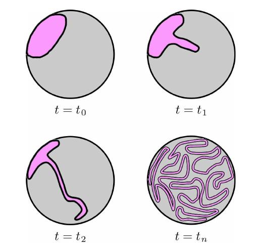

It seems that we disagree on what is coarse graining, so let me explain how I see it, which indeed agrees with all textbooks I am aware of, as well as with the view of Jaynes mentioned in your wikipedia quote. Coarse graining is not something that happens, it's not a process. It's just a fact that, in practice, even in classical physics we cannot measure position and momentum with perfect precision. The coarse graining is the reason why do we use statistical physics in the first place. Hence there is always some practical uncertainty in the phase space. The picture shows how an initial small uncertainty evolves to an uncertainty that, upon coarse graining, looks like a larger uncertainty.
Four circles showing a shaded pink region inside a grey disc at times t0, t1, t2 and tn, with the pink region stretching into thin folded filaments that spread through the whole disc by tn.
Demystifier said:
It seems that we disagree on what is coarse graining, so let me explain how I see it, which indeed agrees with all textbooks I am aware of.
What you describe here is not coarse graining. It's just ergodicity. Gibbs' H-theorem requires a specific way of coarse graining given by an irreversible physical process. If the system is fully governed by Liouville's equation or Bohmian equations of motion, then Gibbs' H-theorem is just inapplicable. Ergodic theory works just fine for deriving statistical mechanics, but this is not what Valentini is using. Valentini tries to argue like in Gibbs' H-theorem, so he must explain how the coarse graining is realized as a physical process.

What you are presenting is not coarse graining. This is the argument based on ergodic theory and it works fine.
No, that's coarse graining, not ergodicity. Ergodicity involves an average over a long period of time, while the fourth picture shows filling the whole phase-space volume at one time. And it fills the whole space only in the coarse grained sense.
There is no coarse graining in your picture. It just shows the trajectory eventually filling the whole phase space. Ergodicity says that ensemble averages are equal to time averages, so if the trajectory fills the whole phase space, then using ensemble averages is justified by ergodicity. That's a standard argument, but irrelevant to Gibbs' H-theorem. Gibbs' H-theorem requires coarse graining as a physical process, not just as a limit on our measurement precision or anything like you mentioned.
No it doesn't. The final pink region has the same area as the initial one, it covers only a fraction of the whole gray disc. It's only if you look at the picture with blurring glasses (which is coarse graining) that it looks as if the whole disc is covered.
Okay, I was too quick and thought the picture shows the trajectory, my bad. But still, there is no coarse graining in the picture, it's just regular Liouville time evolution, so it is not relevant to Gibbs' H-theorem.
I think this description is a little off. What your series of pictures show is a series of "snapshots" at single instants of time of one "cell" of a coarse graining of the phase space (i.e., all of the phase space points in the cell have the same values for macroscopic variables like temperature at that instant of time). At ##t = 0## the cell looks nice and neat and easy to distinguish from the rest of the phase space even with measurements of only finite precision (the exact location of the boundary of the cell will be uncertain, but the boundary is simple and that uncertainty doesn't have too much practical effect). As time evolution proceeds, however, ergodicity (I think that's the right term) causes the shape of the cell in phase space to become more and more convoluted and makes it harder and harder to distinguish, by measurements with only finite precision, what part of the phase space is in the cell and what part is not.
Yes, there is. The blue region in his picture is not a single trajectory. It's a set of phase space points that correspond to one "cell" of a coarse graining of the phase space at a single instant of time. See above.
