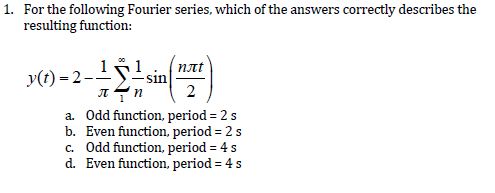

For he following Fourier series, which of the answers correctly describes the following function
y(t) = 2 - [itex]\stackrel{1}{π}[/itex]∑1inf1/nsin(n*πt/2)
a) odd function, period = 2 s
b) Even function, period = 2s
c) Odd function, period = 4s
d) Even functio, period = 4s
From the reading my professor assigned I'm pretty sure that it's odd because it has a sin function, though I still don't understand why.
I'm also confused as to how I find the period. I know that
T =1/f
w=2*π*f
So,
w = (n*π)/2
I'm not quite sure what to make of n.
Any help would be appreciated.
That would be: $$y(t)=2-\frac{1}{\pi}\sum_{n=1}^\infty \frac{1}{n\sin(n\pi t/2)}$$
Check y(-t), if it is the same as -y(t) then y(t) is odd, if it is the same as +y(t) then it is even.
y(t+T)=y(t), what is T?
Certainly the period of the sine function is something to do with 2 units.
But, since it is multi-choice, you don't actually have to find the period - just check to see which of the choices is correct.

The series is a series of harmonics starting with a dc term ("2") and then a series of sine terms
So the first sine term must be the fundamental frequency where n = 1.
So compare sin(nπt/2) with sin(ωt). In other words, compare π/2 with ω since n = 1.
If you know ω, what is the period T?
BTW by "period" they mean the periodicity of the lowest frequency component, i.e. for which n=1.

$$y(t)=\frac{1}{\pi}\sum_{n=1}^\infty \frac{1}{n}\sin \left(\frac{n\pi t}{2}\right)$$
Which would make the RHS a Fourier expansion of something - a saw-tooth wave.
... advise still stands.
... or the period of y(t) - let OP work out if this is the same thing.
a pure sine wave would be: ##y(t)=\sin(2\pi t/T)## where T is the period ... comparing with any other sine wave would be how you find T.
But in this case there is a shortcut. Need only use the definition of the period to check to see if either of the options is the correct one.
Care needed though, if ##y(t+T)=y(t)## then ##y(t+2T)=y(t)## also.
But if ##T## is the period of ##y(t)## then ##y(t+T/2)\neq y(t)##
So it is a matter of putting the numbers into the equation, and thinking about what "period" means.
Which, I suspect, is the point of the exercise.

Understandably so. None of the above, even without knowing what "s" is.
@Northbysouth: any of this help?
You should check LCKurtz answer to see why... would y(t) be easier to handle without the "2 -" out the front?
(i.e. the way I wrote it in post #5?)
It is likely that there is a context missing from the problem statement you got.
