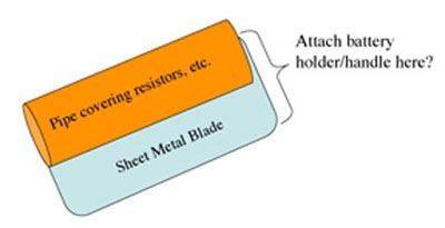

Shay,
I wanted to try this before saying too much. Once you know how to use your meter you are safe to go ahead as follows: Using your 1/2 watt resistor and two D-Cell batteries connected in series [end to end like in a flashlight], go ahead and apply 3 volts across the resistor for ten or fifteen seconds. The resistor will get hot. If you leave the circuit connected long enough, eventually the resistor should burn up.
Potential [V]= 1.5 volts + 1.5 volts = 3 volts
Resistance [R]= 10 ohms
Current = 3 Volts / 10 ohms = 0.3 Amps
Power [P]= VI = 3 volts X 0.3 Amps = 0.9 watts
Since the resistor is rated for 0.5 watts and you are running it at 0.9 watts, you are running the resistor beyond its design limit. This is why it starts to get too hot.
Next, use 4 D-Cells, a 1.0 watt -10 ohm - resistor [available at Radio Shack], a piece of metal about the size of a knife blade, and your heat sinking compound.
By running the batteries in series we get:
1.5 volts X 4 = 6 volts
I = 6/10 = 0.6 amps
P = 6 volts X 0.6 amps = 3.6 watts
Again, I used a 1.0 watt resistor, so I was running the resistor at 360% of the design limit.
I did this using a fairly heavy piece of brass sheet metal - about 1/2" X 2" in size. First, a good layer of heat sinking compound was applied to the metal. Then a toothpaste sized blob was applied and the resistor was secured to the metal using only the cohesiveness of the compound. Pull the resistor's leads back so they don't short out on the metal and wiggle the resistor around a little to ensure a good bond. Also make sure that it's buried in the heat sink blob. This will pull heat away from the resistor and transfer it to the metal; thus preventing the resistor from burning up.
After applying power I that found that an area of about 1/2" X 1/2" got hot very quickly - in less than 30 seconds. Afer five minutes the entire piece of brass was very warm, with half of it too hot to hold. The batteries did not get hot and the resistor was hot but it seemed fine. So it appears that we can safely heat sink the resistors and overdrive them. This seems to work pretty well.

Ok I'm back. I'm sorry. I've just been so busy with a ton of homework and tests these last couple weeks. It's been crazy at my school. The 9-weeks just ended so I'm working all weekend on this project. Ivan Seeking I'm going to try what you said right now.
Sould I use a 20 gauge wire?
  • #102
When I connected the .5 watt 10 ohm to the resistor it seemed hot when I touched it. It was weird (or maybe I'm just weird and it's suppose to feel like this). Are the lines on the resistor the only thing that's suppose to get hot? It did not get the metal hot. Is this because I did not put and heat sink on the metal? Is it suppose to be like this?
  • #103
20 gauge is perfect.
If you look at the connections on the battery case that you linked, you will see that they are wired in series - as if end to end, or on top of each other. So this should work fine. This means that you will have about 6 volts to work with = 4 X 1.5 volts per battery.
On your last question I'm a little confused. The entire body of the resistor will get hot. The lines are your color code - which you are supposed to know by now. :mad:
How many batteries are you using? Two? Then yes, the resistor should get hot. Again, this is producing 0.9 watts of heat in a 0.5 watt resistor. In principle, the resistor should eventually burn up or fail from excessive heat.
When you talk about the metal, do you mean the leads on the resistor or did you get a separate piece of metal? The metal leads on the resistor cannot touch your metal knife blade; or any other conductor for that matter. And you will need to use the heat sink compound to transfer the heat from the resistor's body to the knife blade. This compound will not short out the resistor leads; so it can touch the leads.
Make sure that you learn how to measure the voltage and current as you do this. check that the values measured agree with what you calculate.

Man now I'm hooked on butter cutter technology. Instead of using a resistive circuit to heat the knife why not use a LC circuit resonating inductively with the metal in the blade to heat it. You would get nearly instant heat in the blade I'm not sure on the efficentcy though. This is the same method that inductive ranges and the metals industry use.
Also since you could get nearly instant heating on the blade, divide the handle into two electrically insulated halves. have a circuit measure the capacitance between the two hallves, when someone is holding it there will be a fairly reasonable range of change and the knife can activate. This way you won't wear down the battery of the knife by having to wait for it to get up to temp. Or having to dump a bunch of extra power into the knife to get it up to temp fast enough.
This sounds nearly as weird as the electric spoon I helped design. Had a temp sensor in the laddle and charged itself inductively when in its cradle.
  • #110
I'm so happy :smile: ! The whole piece of metal got hot in a very short amount of time. I used aluminum. The problem is getting the resistor between the two pieces of metal and connecting the two pieces of metal together. A guy at Home Depot told me to use some stuff called liquid nails. Would this work?

Glad to hear its getting very warm now. Of course you could use the multimeter and other resistors and battery combinations to get different heating...wink wink...
Liquid nails would work ok (it comes in different styles for adhering different materials) but just plain 100% pure clear silicone in a squeeze tube would work ok too. I saw some liquid nails brand silicone in a squeeze tube a Walmart just recently for like $3 and you don't need a caulking gun to apply. (its probably at Home Depot too) Clear looks cool. :smile: Oh, and work in a well ventilated area and maybe open a window, all this stuff stinks and you shouldn't breathe more vapor than you need.
Instead of wire connectors, you could likely just twist the wire and the resistor lead together really well. Normally solder would then be used to keep the twist together and improve the connection but if you twisted tight and then used heat-shrink tubing that should work well enough.
The heat-shrink is sometimes tougher to get to shrink evenly than one would think beforehand. For a very short period of time the fire wouldn't affect the resistor but it wouldn't take too long to damage it and heatshrink can cause that. If you could shrink the heatshrink outside the knife before assembly that would ease the process tremendously.
Good old electrical tape works as well (but doesn't look at cool) and if you buy any color other than black it doesn't leave the same gooey adhesive residue when you remove it (if you need to). You can get 3M brand colored electrical tape at Home Depot for like $3-4 a roll.
Oh and twisting wires and taping the connection is a bad practice for any kind of long-term application, but for this that shouldn't be an issue at all...
