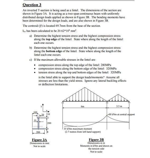

Atom Messages 3 Reaction score 0 Thread starter Apr 25, 2017 #1 Homework Statement Determine the highest tension stress and the highest compression stress along the top edge of the intel. Homework Equations stressx = Mx*y / Ix Ztop = Ix / ytop stress (max top) = Mx - Ztop The Attempt at a Solution Attachments Image 1FSDF.jpg 45.9 KB · Views: 589

gneill Mentor Messages 20,989 Reaction score 2,934 Apr 25, 2017 #2 Hi Atom. By the forum rules you need to show your attempt at solution before any help can be given. What have you tried? What approaches have you thought about?
