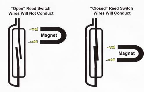

For calculating the speed you could use a reed switch, which is simply a switch that responds to a magnet. Here's a reed switch example image:
Diagram of two reed switches side by side: left labelled "Open" Reed Switch, Wires Will Not Conduct, with a magnet held away and the reed contacts apart; right labelled "Closed" Reed Switch, Wires Will Conduct, with the magnet close and the contacts touching.

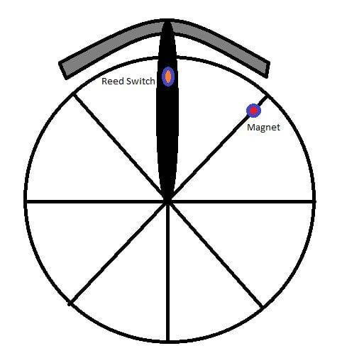

If you place a reed switch on the frame of the wheel, then attach magnet on the wheel. The Arduino would then need to calculate the time interval between each spin, you would also need to specify a few other variables such as tire thickness and wheel circumference then you should be able to calculate the speed. Here's an example of a reed switch for calculating speed:
Diagram of a wheel with eight spokes and a reed switch fixed to a stationary arc above it, with a magnet mounted on one spoke near the rim.
Here is a link that goes into more detail, and also provides some code for the speed calculation that you could use. In their project they display the information on an LCD display, but in your case you could send the data via Bluetooth to your phone app.
https://www.instructables.com/id/Arduino-Bike-Speedometer/

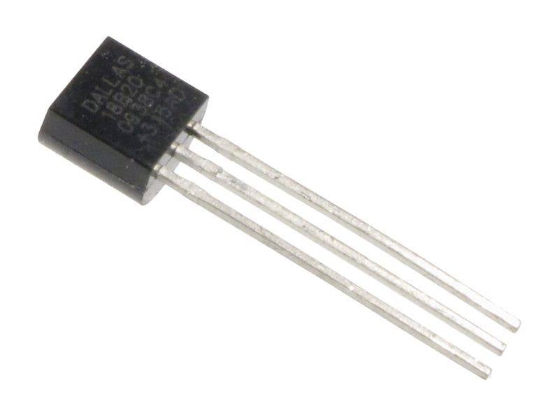

And finally to measure temperature you would need to use a sensor, using one of these is fairly straightforward just connect it up to an Arduino and add some code to read the temperature and send the data across to your phone app. Image of a temperature sensor:
Photo of a black three-pin DALLAS transistor-style package with its leads extending from the lower edge, shown on a white background.
If your scooter is electric you may want to place it near the motor, or maybe one on the battery too! Those parts get the most warm during operation. Here's a useful link about connecting the temperature sensor to an Arduino:
https://www.instructables.com/id/ARDUINO-TEMPERATURE-SENSOR-LM35/
Hope this helps! :wink:
