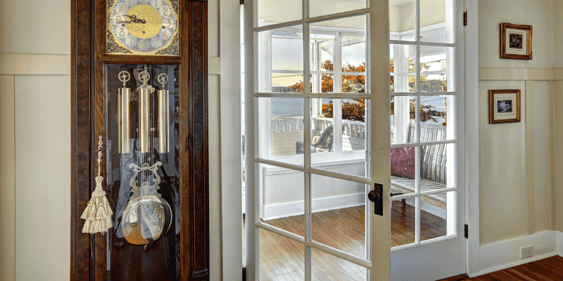

You could make it an exterior display, with a tall vertical mast-like rod (perhaps with a thin sail added for decoration) that supports a long-vertical-travel weight that powers a grandfather clock type mechanism. The weight takes a year-ish to fall the full vertical distance, and there are marks along the mast for the months/weeks/days. The oscillating pendulum for the clock could be down in the club, but the falling mass would be the marker that told folks how long it was until the next race.
The grandfather clock mechanism would not have to be super-accurate, since all you need is for the falling mass to contact the low stop of the mast within a day or two of the race. Nobody will care if it's not accurate to the nanosecond, they will be too excited about the upcoming race near the end of the clock's yearly voyage...
You could add a tradition that the winning crew for the race must hoist the clock weight back up to the top after they win, as part of the awards ceremony. I suppose you could get creative and make the falling mass an anchor or some other such maritime symbol... :smile:

So apparently you never had a grandfather clock in your house when you were a kid (the weights go down, and need to be "wound" back up periodically to keep the clock running). Chiming every quarter hour. And chiming and dinging off the hour count every hour. Hour after hour, day after day... (No it didn't drive me crazy. Why does everybody think I'm crazy!) :wink:
https://www.premierclocks.com/blogs/clock-blog/grandfather-clock-pendulum-and-weights
