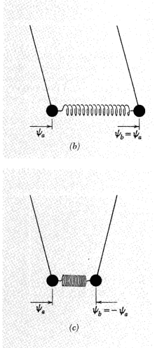

Devise two damping mechanism.
All below
Printed textbook problem 1.6 asking the reader to devise two damping mechanisms, one damping only mode 1 and one damping only mode 2, of the coupled pendulums of Fig. 1.14, and noting that friction at the hinges damps both modes.
Two diagrams of coupled pendulums joined by a spring. In (b) both bobs swing in phase with displacement psi_a and psi_b = psi_a, and the spring is unstretched. In (c) the bobs swing 180 degrees out of phase, psi_b = -psi_a, and the spring is stretched.
I am not sure how i could begin, someone can help me?
In the first mode we have a spring not stretched, while in the second, is not only stretched but the balls are outing of phase by 180 ° too.
Damping the oscillation of the spring is pretty easy, no?
Allowing free out of phase movement, but damping in-phase is trickier. Maybe start with a mechanism that would only permit out of phase motion, then see how to relax that to a merely frictional constraint.
Lagrangean
[tex]L=\frac{1}{2}m_a \dot{\psi_a}^2 + \frac{1}{2}m_b \dot{\psi_b}^2 - \frac{1}{2}k(\psi_a-\psi_b)^2[/tex]
would determine the motion but it does not show friction or damping.
