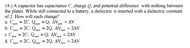

for #14, I remember a battery maintains the potential therefore, V should be constant; dielectric increases charge on plates and increases capacitance but I couldn't find an option that matched.
The answer key says "d" but I believe V should stay the same so perhaps there is a typo?
Can anyone confirm this?

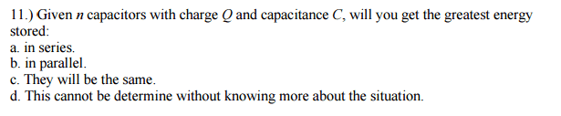

Another question:
Could someone explain this to me? Answer key says C.
I thought in series, Ceq = C1 + C2 + C3...
and in parallel Ceq = 1/C1 + 1/C2 + 1/C3...
For the first part, i agree with you that the potential difference between two plates should be the same because it is still attached to a battery. For the second question, think it this way: which quantity is the same for all the capacitors when you connect them in parallel, while which quantity is the same when you connect them in series?
in series, Q is constant through out.
Parallel , V is constant through out.
Your formulae for the equivalent capacitors are wrong. They are not the same as in case of resistors!
Yea, you can work out from there. Try to find the total energy from the Q,C,V.
whoops, for Ceq = C1 + C2 + C3... in parallel
Ceq = 1/C1 + 1/C2 + 1/C3... in series
