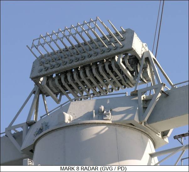

The first microwave scanning phased array antenna was built during WW2 by the MIT Rad Lab--it is the Mark 8 fire control radar antenna and it used polyrod radiating elements.
The polyrod element guided and radiated EM waves just as we now guide and radiate light through an optical fiber. You can read about them here

This includes the radar antenna that @marcusl posted aboveDave

An axial dielectric rod can be used to focus radiation from a launcher such as a feed horn. The rod does not launch the EM wave, it focuses, or aligns it, after it has been released from the conductive transmission line and antenna structure.
The velocity of the EM wave in the dielectric is lower than in air so the energy tends to follow the rod surface, until it runs out of rod and continues through space.
