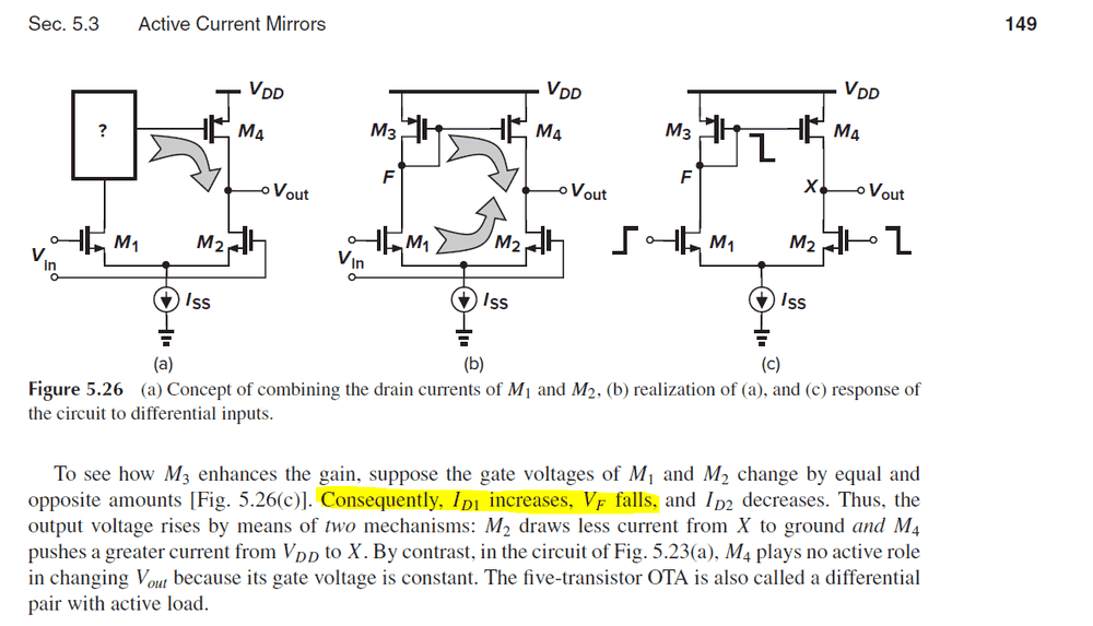

This isn't a homework problem but it's a question I had in mind when I was reading about Differential Amplifiers with Active Loads in the book "Design of Analog CMOS Integrated Circuits" by Behzad Razavi.
N/A
The highlighted part is what I don't understand. Due to the gate voltage increase in M1, the current in the left branch should increase. That makes sense to me. However, he then says that the voltage at node F (in other words the drain of M1) decreases? How?

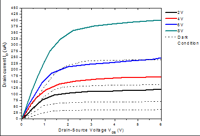

Look at this plot:
As current in the NMOS device increases, the drain-source voltage Vds also increases. Thus shouldn't voltage at node F (drain of M1) also increase? Why has he said it decreases?

You need M3 to have a negative resistance to increase voltage at point F after application of increased voltage at gate of M1. As long as differential resistance of M3 is positive (always for diode-connected MOSFET), any increase of M1 current will result in drop of voltage at point F.

It is not very meaningful to look on M1 alone to estimate its terminal voltages because it not connected to any voltage node directly. All connections are through current sources. For manual voltage estimation, use devices connected to voltage nodes (M3 in this case).

So in the I/V characteristic plot, the slope increase (increase in Id for increase in Vds) in the saturation region is just to show the effect of the channel-length modulation right? And I shouldn't be using that here?
