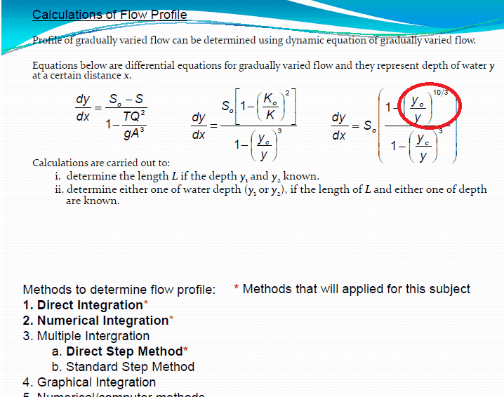

I have no idea how the third formula of dy/dx is derived ...
I know that the Q = (1/n)(A)(R^2/3) [(s)(^0.5)] ,
Q = K [(s)(^0.5)]
, so , K= (1/n)(A)(R^2/3)
i know that for very wide channel , y = R
A = by
K= (1/n)(A)(R^2/3)
= (1/n)(by)(y^2/3)
= (1/n)(b)(y^5/3)
Thus , (K^2) = [[ (1/n)(b)]^2 ](y^10/3)
but , it seems that the author just got (y^10/3) ,
So , is the author wrong ?
  • Slide with three differential equations for gradually varied flow: dy/dx = (S0 - S)/(1 - TQ^2/(gA^3)), dy/dx = S0[1 - (K0/K)^2]/(1 - (y0/y)^3), and dy/dx = S0(1 - (y0/y)^10/3)/(1 - (y0/y)^3), with the exponent 10/3 circled in red.

On first sight: no. Consider ##{K_0\over K}## instead of just ##K##.

sorry , i mean $$K_0$$ corresponds to $$y_0$$
and $$K$$ corresponds to $$y$$
Yes, I understand. Don't the n's and the b's cancel ?

in my working , i can't cancel the n and b ... Is there anything wrong with my working ?
Not from what I can see :smile: because what I can see is nothing ...(refer to post #2). I have no idea what this is about.
I see you write ##K^2 = (b/n)^2\; y^{10/3}## and I add ##K_0^2 = (b/n) ^2\; y_0^{10/3}## leading to ##\left ( {K_0\over K}\right ) ^2 = \left ({y_0\over y}\right )^{10/3}##. That simple.
