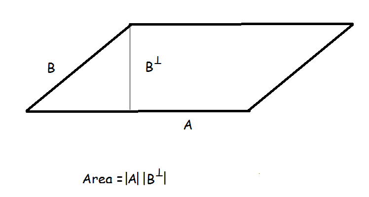

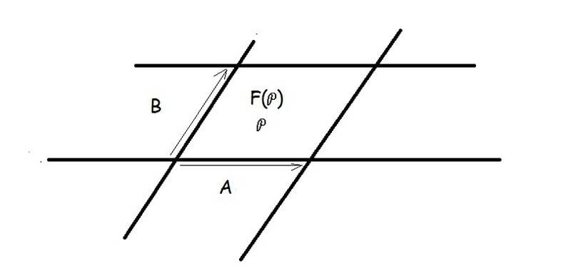

kent davidge said:
Thanks for answering. Why integration and differentiation in general is chosen to be performed with antisymmetric(0,n) tensors ? Why not on other type of tensors?
The simplest case to understand is integration over a curved 2-D manifold with a metric. And let me assume a Riemannian metric (so we can assume that the square of any vector is defined and positive). The case for an indefinite metric (so the square of a vector can be negative or zero) and for higher-dimensional manifolds will be left as an exercise :wink:.
Using the usual definition of an integral, if we are integrating a scalar function [itex]F[/itex] over the 2-D space, we can approximate it by dividing space up into lots of little parallelograms, and compute
[itex]\int F = \sum_i \mathcal{A}_i F(\mathcal{P}_i)[/itex]
where [itex]\mathcal{A}_i[/itex] is the area of parallelogram number [itex]i[/itex], and [itex]F(\mathcal{P}_i)[/itex] is the value of [itex]F[/itex] at the point [itex]\mathcal{P}_i[/itex] somewhere inside the parallelogram. So integrating a scalar function over a 2-D manifold is reduced to the problem of computing the area of a tiny parallelogram.
The rule for the area of a parallelogram in good old Euclidean geometry is just:
[itex]\mathcal{A} = base \times height[/itex]
So if [itex]A[/itex] is the displacement vector (which is approximately well-defined for small displacements, even in curved space) for one side of a small parallelogram, and [itex]B[/itex] is the displacement vector for the other side, then the area will be:
[itex]\mathcal{A} = |A| |B^\perp|[/itex]
where [itex]B^\perp[/itex] is the component of [itex]B[/itex] perpendicular to [itex]A[/itex]. (And where [itex]|X|[/itex] means the square-root of [itex]X \cdot X[/itex], which is real and positive for Riemannian manifolds, which we're assuming.)
We can compute [itex]|B^\perp|[/itex] in terms of the vector dot-product. [itex]|B^\perp| = \sqrt{B \cdot B - \frac{(A \cdot B)^2}{A \cdot A}}[/itex]. So we have:
[itex]\mathcal{A} = |A| \sqrt{B \cdot B - \frac{(A \cdot B)^2}{A \cdot A}} = \sqrt{(A \cdot A) (B \cdot B) - (A \cdot B)^2}[/itex]
Or squaring both sides gives:
[itex]\mathcal{A}^2 = (A \cdot A) (B \cdot B) - (A \cdot B)^2[/itex]
At this point, let me introduce the alternative way of writing vector dot products. The dot product [itex]X \cdot Y[/itex] can be written in terms of the metric tensor [itex]g_{\mu \nu}[/itex] as [itex]X \cdot Y = \sum_{\mu \nu} g_{\mu \nu} X^\mu Y^\nu \equiv X^\mu Y_\mu[/itex], where [itex]Y_\mu \equiv \sum_{\nu} g_{\mu \nu} Y^\nu[/itex]. So in this notation, we can write:
[itex]\mathcal{A}^2 = A^\mu A_\mu B^\alpha B_\alpha - A^\mu B_\mu A^\alpha B_\alpha[/itex]
Now, introduce the two-index tensor [itex]\mathcal{A}^{\mu \alpha} \equiv A^\mu B^\alpha - A^\alpha B^\mu[/itex]. We can prove the following identity:
[itex]\mathcal{A}^{\mu \alpha} \mathcal{A}_{\mu \alpha} = (A^\mu B^\alpha - A^\alpha B^\mu)(A_\mu B_\alpha - A_\alpha B_\mu) = A^\mu A_\mu B^\alpha B_\alpha - A^\mu B_\mu A^\alpha B_\alpha - A^\alpha B_\alpha A^\mu B_\mu + A^\alpha A_\alpha B^\mu B_\mu = (A \cdot A) (B \cdot B) - (A \cdot B) (A \cdot B) - (A \cdot B) (A \cdot B) + (A \cdot A) (B \cdot B) = 2 ((A \cdot A) (B \cdot B) - (A \cdot B) (A \cdot B)) = 2 \mathcal{A}^2[/itex]
So we have:
[itex]\mathcal{A}^2 = \frac{1}{2}\mathcal{A}^{\mu \alpha} \mathcal{A}_{\mu \alpha}[/itex]. (The factor of 1/2 is a little worrisome, but I think it's because the implicit summing over [itex]\mu, \nu, \alpha, \beta[/itex] double-counts; the sum includes the non-summed term [itex]A^\mu A_\mu B^\alpha B_\alpha[/itex] and [itex]A^\alpha A_\alpha B^\mu B_\mu[/itex] for each [itex]\alpha[/itex] and [itex]\mu[/itex].)
So the area tensor for the parallelogram of vectors [itex]A[/itex] and [itex]B[/itex] is antisymmetric.
