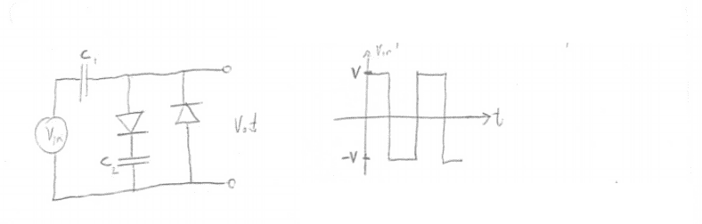

Graph ##V_{out}##
When ##V_{in}=V## C1 is positive on the left and negative on the right, and C2 is negative on the the down side and positive on the upper side so there is no Vout?

That's not correct.
For the moment let's assume that V is much greater than the forward voltage of the diode...
When Vin = +V the right hand diode is reverse biased (not conducting) so that can be temporarily removed. The left hand diode is forward biased (conducting) so replace it with a wire. Redraw the circuit to show this.
Then... Are you familiar with the "Potential Divider" circuit?

Why is the left hand diode is conducting? the capacitors do not affect the voltage? do not they both charge to the same voltage and the diode is not conducting?
No they don't charge to the same voltage (unless they are same value). The two caps are in series.

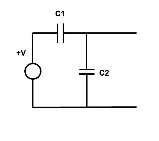

This is what the circuit looks like when Vin transitions from 0 to +V (assuming +V >> Vd)...
