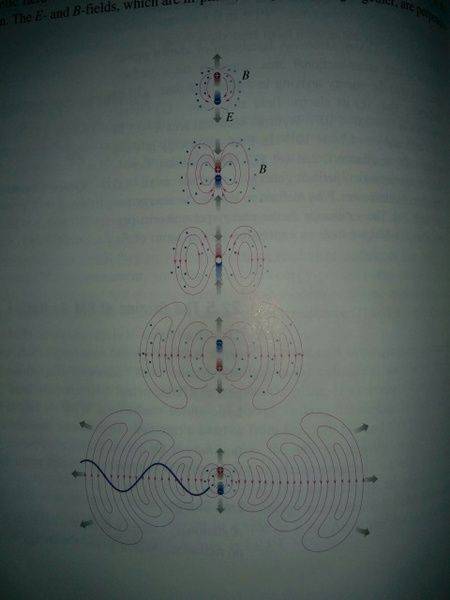

The E and B field lines of a dipole radiating EM waves looks like that (sorry for the poor quality) :
What I wonder is how can we see that the amplitude of the fields decrease as 1 / r? When you look as such a picture it actually feels likes the amplitude should rises. The E field gets "elongated".
But I know that the radiated energy is spread over a growing sphere/torus like shape, thus the fields amplitude must weaken over time and distance.
I don't understand how the fields weakens when I look at those EM radiation drawings.
Also I don't see how to make the link between the picture of a radiating dipole, like the one above, and the picture of a plane EM wave. What's even more confusing is that :
1 - if the radiation sphere is huge, you can approximate the radiation at a point as a plane wave radiation.
2 - BUT plane wave radiations don't decrease in energy. Their field amplitude maximum stays the same.
3 - So what? Is the decrease too small to be taken in account when we are close to a huge radiation sphere?
Individual field lines show only the direction of the field at points on the lines.
If the field lines are drawn "properly", their spacing (separation) in a region should correspond roughly, in an indirect way, with the magnitude of the field in that region. Larger spacing would mean smaller magnitude (weaker field). It doesn't appear that your book's diagrams have been drawn carefully enough to show that.

It shows the maxima and minima of the field within a few wavelengths of the source. It's not big enough to show how the amplitude of the maxima decrease as 1/r as you get further and further away from the source. For that, I think you need a diagram that is many wavelengths wide so as to get away from the near-field region.
Correct. If you're 10000 meters away from a radio transmitter, and compare the field amplitude at 10000 m with the amplitude at 9999 m, the difference is going to be only about 0.01%.

If the field lines spacing increases, how does the wavelength keeps constant?

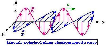

Hm, in EM plane wave drawings like the one below, the field strength there is shown by the vectors magnitude right? Just to be sure I'm not misreading the drawings. It's a little confusing.
The wavelength is the distance between the places where the field lines are "bunched up" closest together, or the distance between the places where the field lines are "spread out" the furthest from each other; not the distance between the individual field lines. The animation on the Wikipedia page shows about one and a half wavelengths from the antenna in either direction.
Right. If you were to draw field lines on top of that, they would run vertically and bunch together at the z-positions where the field strength is a maximum in either direction (the upwards and downwards peaks).

Yes, but if the overall magnitude of the fields decreases as 1 / r, then all the lines must be further and further from each other with increasing distance. Both the places where they are more compact (high magnitude) and where they are more spread (low magnitude) must overall be more spread. And still that doesn't affect the wavelength, why?
It's hard to picture, I'll see if I can find some drawing.
Within successive regions in which the field lines are spaced closely together, the lines become further apart (the maximum field strength becomes weaker). But those regions maintain the same distance from each other (the wavelength remains the same).
Ok, I think I finally get it.
I was going to ask how can the lines become further apart because all of space is already "full" of lines. But it is the principle of field lines to assume that some regions have higher densities of lines and some lower densities. Hence, a region with a high density can always spread out, so that the surroundings local densities goes a little up everywhere and the overall region density gets lower. Or more simply, the same quantity of lines take up more space.
What I find confusing with field lines is that it's a kind of drawing with which you can "zoom" in or out as much as you want, and the space is still full of lines everywhere no matter the zoom level. But still, we define some places with higher densities than others. I think this confuses me sometimes.
So here the "compact" regions spread out synchronously into the less compact ones, until everything is smooth, same density all over, which means 0 amplitude. At infinity, I guess.

These are just illustrations. You seem to think that all such illustrations must conform precisely to some exact standard with precise interpretations.
Illustrations are just pictures intended to convey some point, which is described in the figure caption and text. If you really want to learn it you must understand the math behind the illustration. There is no one size fits all explanation for these figures.

I realize those illustrations can't be quantitatively precise, but I expect them to be accurate at least qualitatively. Otherwise they would be useless, I think. While they have not as much value as the equations, it is important to me to understand them, because they usually help me to get a feeling with the equations. And after all, they are just another tool to understand the physics.
That said, it seems wise indeed to not give them too much credit in the sense that they are NOT a picture of reality, which cannot be "draw" but is only described accurately (up to a certain point I guess) by the maths. At least that's how I understand your answer. :D Thank you for the advice, I should keep that in mind.If I may ask one last thing regarding illustrations : in a dipole radiation such as the one pictured here (description here), is there a way to intuitively interpret why/how the E field lines detach from the dipole? The lines of the radiation appear to slowly "close" themselves, one by one, becoming thus independent from the dipole. In what I believe is labelled as the "induction zone" (the other two zones being the "radiation zone" and the "quasi static zone")?
Is there an intuitive way of understanding it, or are we solely limited to saying "well, when you run a software with the equations, it looks like that"?

I think that the problem is less whether they are quantitatively correct vs qualitatively correct and more about the fact that each illustration means something different. Do you recognize that the arrows and lines in the figure in post 1 have very different meanings than the arrows and lines in post 5? You have to read the corresponding text carefully to understand what is being represented in each case.
Field lines begin and end on charges, and yet the lines on post 5 begin and end in free space, so they are not the traditional field lines. Does the associated text with each figure give you some clues about this difference in the drawings?
Not really sadly. It would have been great to read somewhere something like "careful those are not traditional field lines" about the pictures like in post 5. Even if it looks obvious.
Having those different representations definitely confused me. As you wrote, this was a source of problem. It is true that each picture should be carefully understood in its own context. Thanks for the advice.
So the E-field is a vector field, and vector fields are fundamentally difficult to draw on paper. As a result there are a variety of techniques used to visualize them. To understand the difficulty, I would encourage you to get some math software and try using even pre-packaged plotting functions to show them for some basic vector fields.
The E-field lines drawn on the figure in post 1 are so-called "streamlines". They are lines which have the property that the tangent to the curve at each point is in the same direction as the vector field at that point. Streamlines, by themselves, do not provide any information about the magnitude of the vector field, only its direction.
The E-field lines drawn on the figure in post 5 are vector field plot lines. The direction and length of the arrows directly represent the direction and the magnitude of the vector field, evaluated at the point where the tail is located. There is no information provided about any points anywhere other than exactly on the z axis.
