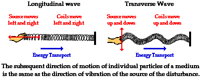

2. Better wifi cartoon but wifi signal looks like Longitudinal Sound Waves, coming at you in same direction as Force or Motion. Missing are Electromagnetic Transverse Waves that follow Right Hand Rule.

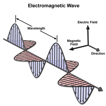

3. Above Transverse depicts EM Waves, but most cartoons of EM Waves from sun or star fail to show full Right Hand Rule or Magnetic Field 90 degrees from Electric Field perpendicular from Direction of Motion, so kids again think EM Waves from sun must be Longitudinal hitting your face in direction of Motion not Transverse which radiate 90 degrees from Motion.

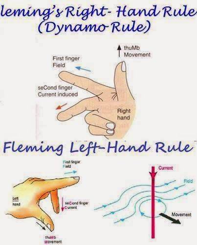

4. Right Hand Rule is great for kids but I never see it applied to wifi logos.
5. Many EM Wave graphics like this one are great explaining how they move but are really hard to imagine in nature. I imagine water ripples radiating away from pebble thrown into pond, but that fails to capture whole EM wave, like which ripple is magnetic and how is it 90 degrees perpendicular from electric?

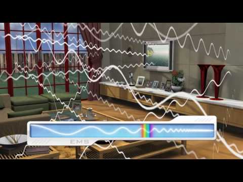

6. This NASA video is great explaining EM spectrum, and above graphic is great showing various waves hitting us constantly, from sun, TV, phone, microwave, etc. But above waves don't show right hand rule, so how could we add magnetic 90 degrees from electric waves and what would that look like?

Personally, I would say that suggesting that EM waves actually "look like" anything, would be to open a massive can of worms. That is unless they happen to be light waves - in which case we don't see the waves - just the effects.
If you haven't got it all totally sorted in your mind, you risk getting asked questions that you just cannot answer without getting in deeper and deeper. Kids are very literal and will grab onto any half baked model and try to apply it to take themselves further down blind alleys. You really have to begin with a massive caveat about the fact that EM waves are not like anything they have come across but that water waves (etc) have some common properties.
I understand your problem with Figure 2, which could suggest that the waves are longitudinal but, otoh, EM waves are not the slightest bit like the wiggly things in the 'room full of waves', either. You need to keep it deliberately airy fairy until they can handle the notion that those side to side diagrams all refer to Field Vectors and that nothing actually wobbles from side to side in EM waves. The Roomfull of Waves is very good for the message that there are all wavelengths passing through a room (rather than 'hitting you'.
