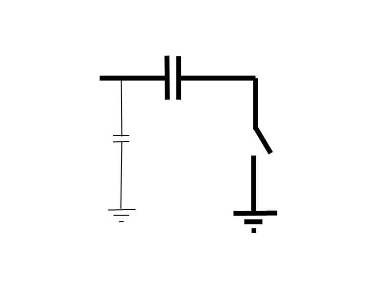

Perhaps visualise your circuit like this...
The main capacitor is shown in bold and the left hand side is the unconnected plate. Charles mentions a wire and I have shown a small stray capacitance between the wire and ground. The voltage on that small capacitor is given by..
ΔV=ΔQ/C
If C is very small or approaches zero then any change in Q produces a large voltage change so the charge doesn't have to redistribute much.
You can argue that there need not be a wire but that just makes the stray capacitor even smaller.
