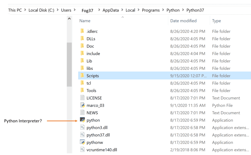

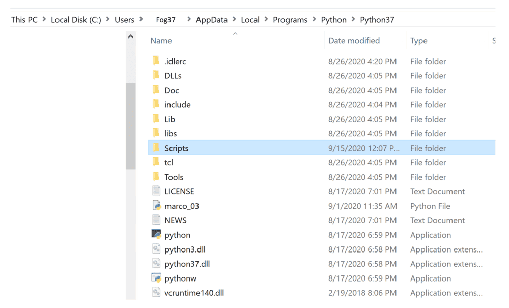

Hello,
Today I successfully installed the numpy module (which wasn't installed) using pip but I am not sure what was really going on exactly. On the command line, I typed python - m pip install numpy
  • Where did the pip program manager install the numpy module? In which folder can I find the numpy module (or package)?
  • Also, the pip program itself is not installed in the system32 folder. The folder system32 is the current folder, correct? How can I run pip from there?
  • pip is installed in the subfolder Scripts in the folder Python37 where I see the program python which is not installed in the subfolder system32...Is that the python interpreter? If so, can I use the interpreter directly if I click on it instead of using the IDLE or the command line?
However, it seems that the shortcuts to the IDLE and to the interpreter (Python 3.7 (64-bit)) are installed elsewhere in the Start Menu folder (see below). Is this a good practice?
The system32 folder on Windows is not for programs; it's for system libraries. Programs are not installed there. I have no idea why you would need to run any program from that folder. As for pip, it doesn't matter which folder you run it from; it doesn't care what your current folder is.
Also, pip is not a standalone program, it's a Python module (actually it's a package, see note below). When you issue the command python -m pip install numpy, the program you are running is python; that program then loads the pip module and runs it as a script. See the Python documentation (remember what I said about the answers to your questions already being in the Python documentation?) here:
https://docs.python.org/3/tutorial/modules.html#executing-modules-as-scripts
Note that pip is actually a package, so when you run it as a script this way, the module that gets executed as a script is actually the __main__.py file in the package. See the Python docs (there's the docs again...) here:
https://docs.python.org/3/library/__main__.html?highlight=__main__ py#module-__main__
The python program in the Python37/Scripts folder is the python interpreter executable, yes. Python scripts that can be run as standalone programs also get installed there. So instead of typing the command python -m pip install numpy, you could just type pip install numpy and it should work. If you look at the source code of the pip script in the Scripts folder, all it really does is import the pip package and run the same function the __main__.py file in that package runs if you run it as a script with python -m.
