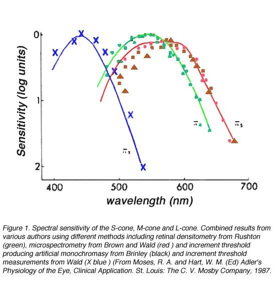

ps. Strangest things I've discovered this morning thinking about your question:
1. The red cones in our eyes are most sensitive to spectral yellow light. It's only the lack of input from the green sensitive cones that makes things look red, as we move to longer wavelengths [ref]
by eyeballing his graph {590 nm}:

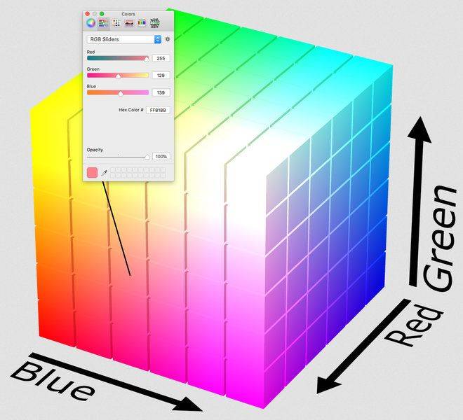

2. As far as RGB levels go, 'black' is just a really dimmed down version of 'white'.
Code:
name   Hex        RGB             HSV
White  #FFFFFF    (255,255,255)    (0°,0%,100%)
Silver #C0C0C0    (192,192,192)    (0°,0%,75%)
Gray   #808080    (128,128,128)    (0°,0%,50%)
Black  #000000    (0,0,0)          (0°,0%,0%)
[ref]

The RGB values assigned to a color are highly relevant to your question, because they're designed to be relevant to RGB monitors, which in turn are intended to serve as input devices for the human eye. I would photograph the two pads side-by-side, under any reasonable lighting conditions - the flash from a digital camera or cellphone ought to do nicely. (The light source affects appearances, as notedd by others, but any reasonably white light won't much affect the relative "redness" of two similar colors.) Open the image on a Mac using Preview, and use the color picker as shown above to get the RGB values. (On a PC, Photoshop or the like will do the trick.) Let's call the results r, g and b.
If you can agree that the "redness" of a color can be measured by its distance from pure red (the lower left corner of the above color cube), you have a re-statement of your question that can be answered quantitatively. The distance from pure red (255, 0, 0) is the square root of [(255-r)2 + g2 + b2].
In the example above, all points on the front plane of the cube are fully red (r = 255), but the selected point is removed from the pure red corner by g=129 and b=139. Per the formula, the distance from pure red is the square root of [02 + 1292 + 1392], or about 189.6. (Your colors are likely to have values of R that are other than 255, meaning that they're somewhere within the volume of the color cube, but only the surfaces are visible in the image of the cube I'm using as an example.)

James Demers said:
The RGB values assigned to a color are very relevant to your question, . . . . . . . . .
This is ok as far as it goes but you are concentrating on Colour Synthesis. The really important process is the Analysis that your eye does and, without getting onto Primaries at all, there are many different spectral distributions that will give any chosen 'colour', as appreciated by the brain. Matching to a given paint sample, using RGB values from an analyser will not tell you the spectrum that's being reflected off that paint. Whilst the Colour TV approach is very successful and definitely near enough for many purposes, it is an approximation. A spectral analysis of the light from a surface plus the spectral analysis of the illuminant will tell you much more and it will allow you to produce a 'perfect' match under any other illuminant.
I just mean that it ain't that simple.
Agree 100%, but the question of "which is redder" is a question of perception, at least to my way of thinking. To the extent that one agrees on the use of distance in RGB color space as the measure of "redness", I think my solution answers the OP's question.
For example, when asking which of two colors is "more yellow", it doesn't matter whether a perceived "yellow" is yellow light, or the equally-yellow result of red and green light. Spectral analysis can tell you this, but it doesn't help answer the question.
No problem with that except that your RGB space relates to particular primaries, I think. The tristimulus values X,Y (and possibly Z) would not be 'primary specific'.
