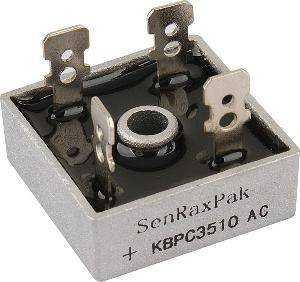

Hi , I have a 50khz square wave from a smps transformer and currently I am using MUR 1620 fast diodes but since they come in individual trasistor type TO220 type packages I have some problems with attaching them properly to heatsink , does anyone know are there any nice diode bridge modules like those that come for mains 50hz that could be used for high frequency ?
I want something like in the attached picture

what max current rating do you need ( as in maximum current likely to be drawn) ?

No it's ok to 220does attach ok to heatsinks it's just that the smps is custom built and I didin't have good neough place for the many required fast rectifier diodes , I did manage to get them in but if I could have a solid square 4 pin bridge like I have for mains that would be much better for me and much easier to attach thermally , my average need is about 400v peak reverse voltage and about 20/30 amps of forward current that would be enough probably with reserve
so I was just wondering whether such things exist like fast diode rectifier bridges for square wave rectification
or are there only individual to220 packages that are then arranged by 4 in a bridge?

I have searched a couple of the major component suppliers and have not been able find a 4 diode high speed and high current packageDave
Rather than using 4x MUR1620 single fast recovery diode.
Use dual diodes, MUR1605CT common cathode, with MUR1620CTR common anode.
yes, that is the other way I was going to suggest if the secondary winding isn't centre-tapped
