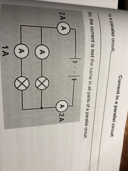

I am confused since my textbook says current in parallel circuits are shared between junctions. XD . Am I missing something or should I lodge a complaint with my teacher? And yes i really would like to start getting familiar with circuits so please recommend some materials to me. Much thx

The total current is indeed split between the various branches of a parallel circuit, but that does not necessarily imply that the current is less in each branch. It could just as easily mean that the total current is greater instead. In fact, your observation that it does not get dimmer clearly indicates which of those two possibilities occurs.

So can I say the overall current in a parallel circuit is greater than in a series circuit?
Yes, with the assumption that the circuit power supply provides the same voltage in both cases. Most power supplies are voltage sources, so that is usually a valid assumption.
