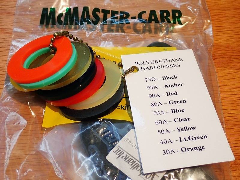

Plastic hardness is rated in durometer. Engineers understand durometer. A sample pack is a good, low cost, investment to understand what different durometer hardness feel like. A good sample pack costs $25.00 from McMaster-Carr: https://www.mcmaster.com/8450K4/. Highly recommended. And a photo of it:
They also have other sample packs.
