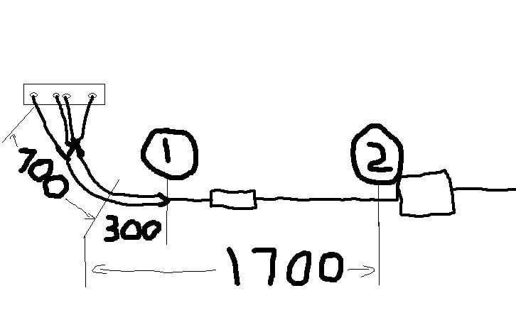

I have done a crude test and started a thread on another forum to compare results, I can put my test on video and host on youtube if needed.
I took my car for a drive until it warmed up ~195 deg F (thermostat) then I checked the exhaust temperature after letting it idle for a few mins I used my hand and then water.
The outside temperature was 24.8 Deg C, RH 41%, wind SSW 20km/h.
Point 1 in the pic was where water was just starting to boil when sprayed on the pipe approx 1 m of plumbing.
So a 75 degree C above ambient, The engine was approx 90.5 deg C also
Point 2 in the pic was where I could just touch it for about 1 second approx 2.4 m of plumbing.
So a rough guess 55 Deg C
The end of the system at the rear of my car I could hold on to the pipe.
Maybe 40 deg C?
Hand-drawn schematic of an exhaust system: a manifold with three pipes on the left, labelled 100 and 300 for distances, then marked points 1 and 2 along the pipe, a small box, and a larger box at right; 1700 is marked as the total length.
I have started a topic on the speed talk forum see http://speedtalk.com/forum/viewtopic.php?f=1&t=25862"
I did it to get some clue on what the normal temp is with other engine.
There is a report of a person has just started an engine for a few mins and he put his hand on the exhaust pipe 10 inches back from the end and burnt his hand.
Ok so If I have lower exhaust temp then my engine is more efficient, I need some one to measure mine one day.
