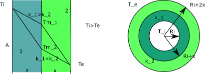

Given geometric conditions of equality on a flat surface
[tex]A_1 = A_2 = A[/tex]
Y
[tex]x_1 = x_2 = x[/tex]
For the same temperature difference the inversion of the layers results in the same rate of transfer of energy or heat.
[tex]Q = \dfrac {A (T_i-T_e) k_1k_2}{x (k_1 + k_2)} = \dfrac {A (T_i-T_e) \mu}{x}[/tex]
[tex]\mu = \dfrac {k_1k_2}{k_1 + k_2} = \dfrac {1}{\dfrac {1}{k_1} + \dfrac {1}{k_2}}[/tex]
The difference lies in the fact that the temperature at the junction interface between materials is subjected to different temperatures, tm is higher if the material with the highest thermal conductivity is the one exposed to the source of the highest temperature.
But in cylindrical condition
[tex]R_ {avg1} = R_i + \dfrac {x}{2}[/tex]
[tex]R_ {avg2} = R_i + \dfrac {3x}{2}[/tex]
[tex]A_1 \cong2 \pi R_ {avg1} L[/tex]
[tex]A_2 \cong2 \pi R_ {avg2} L[/tex]
[tex]A_2> A_1[/tex]
[tex]e = R_i + x-R_i = R_i + 2x- (R_i + x) = x[/tex]
then if the material with the highest conductivity is internal
[tex]k_1> k_2[/tex]
if the material with the highest conductivity is in the inner layer
[tex]Q_A = \dfrac {T_i-T_e}{x} \dfrac {k_1 A_1 k_2 A_2}{k_1A_1 + k_2A_2}[/tex]
if the material with the highest conductivity is in the outer layer
[tex]Q_B = \dfrac {T_i-T_e}{x} \dfrac {k_1 A_1 k_2 A_2}{k_1A_2 + k_2A_1}[/tex]
If we make the ratio of both equations
[tex]\dfrac {Q_A}{Q_B} = \dfrac{k_1A_2 + k_2A_1}{k_1A_1 + k_2A_2}[/tex]
Replacing what their surfaces are worth
[tex]\dfrac {Q_A}{Q_B} = \dfrac {k_1 (R_i + \dfrac {3x}{2}) + k_2 (R_i + \dfrac {x}{2})}{k_1 (R_i + \dfrac {x}{2}) + k_2 (R_i + \dfrac {3x}{2})}[/tex]
Distributing and ordering
[tex]\dfrac {Q_A}{Q_B} = \dfrac {(k_1 + k_2) R_i + \dfrac {x}{2} (k_1 + k_2 + 2k_1)}{(k_1 + k_2) R_i + \dfrac {x}{ 2} (k_1 + k_2 + 2k_2)}[/tex]
So if [tex]k_1> k_2[/tex] is satisfied
It follows that [tex]\dfrac {Q_A}{Q_B}> 1[/tex]
Then [tex]Q_A> Q_B[/tex] there is a better transfer rate if the smallest surface area is the one with the highest conductivity and is in contact with the hottest fluid
