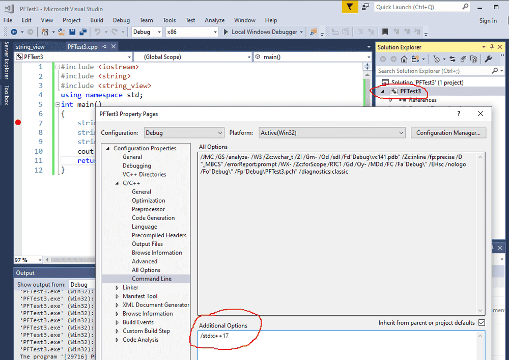

I am playing with string_view which is C++17, I have VS-2019, it doesn't seem to recognize string_view. I cannot even troubleshoot my program:
C++:

Here's what I did, and I'm running VS 2017.
  1. In VS, select the project. For me this is PFTest3.
  2. In the right-click menu for the project, at the very bottom, click Properties. This opens the Property Pages dialog for the project.
  3. In the left pane, scroll down to C/C++ and then to Command Line under C/C++.
  4. In the Additional Options pane near the bottom of this dialog, type in /std:c++17 .
  5. Click OK. (I don't show this button in the screen shot below.)
You should then be able to build and run your code.

Thanks so much Mark44. It works My program compiles.

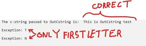

Please help me on this. I am translating the program in post#8 to use only c-string instead.
After I translate the program, it only print out the first letter of the string literal. eg, the first sentence is only "T" instead of "There is a problem". See output of program below.
I verified the way I pass the string literal to a function shown in line 20 to 23 and got the whole sentence "This is OutCstring test".

This is the output:
C++:
The c-string passed to OutCstring is: This is OutCstring test// test passing string literal to function
message: There is a problem //Print in line 11 to show message contains “There is a problem”
Exception: T //Only the first letter of the sentence “There is a problem”
message: Nobody knows the trouble I've seen... //Print in line 11 show it got copied correctly
Exception: N //Only the first letter of “Nobody knows the trouble I’ve seen……
I don't know what went wrong, please help
Try look at the return type for your what() method.

yungman said:
I kind of thinking it's the return type
It is so basic I wonder how you cannot spot it yourself. You have declared the what() method to return a char. Does this match any kind of string type? If no bell rings yet then try to look at one of the many examples involving C-strings you already have discussed here on PF.

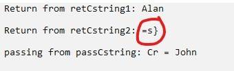

I tried before, I can't find a way to make it work. This is the program I was working on, you can see the one in the middle doesn't work.
C++:

    //strncpy_s(Cr, csize, retCstring2(), csize);
    count << " Return from retCstring2: " << retCstring2() << "\n\n";//wont work.
    passCstring(Cr);
    count << " passing from passCstring: Cr = " << Cr << "\n\n";
    return 0;
The output is:

To rehash and summarize:
1. A function cannot return a C-string in C. (Or C++)
2. A function can return a pointer to a C-string. However, one must take care to ensure this pointer points to the string, and not a memory location where the string used to be.
C++:
const char* retCstring2()
        const char Cret[] = "Paul";
        return Cret;
That's because retCstring2() is returning a dangling pointer. The array Cret[] is a local variable which goes out of scope as soon as the function returns. So, the pointer returned by retCstring2() points to memory that is no longer available.
The result is undefined behavior. If you're lucky the memory won't yet be overwritten when you try to use the pointer returned by retCstring2() , but in general this is not guaranteed. In the real world, Murphy's Law means that it will work when you test it, you'll ship it to customers, and it won't work for them.
As I've mentioned in a previous message in another thread, the only way to do what you're trying to do is to allocate an array of storage using new, copy the string into that array, and return a pointer to that array.
But then the burden falls on the caller of your function to delete the storage. This leads to all sorts of memory leaks when users fail to do so. The natural thing to do is to create a class that performs the new in the constructor and the delete in the destructor, hence cleans up after itself. But this is just a very poor duplication of what std::string already does, so why not use std::string?
The only other alternative is something like your Trouble implementation, which uses a fixed-size array and thereby avoids the new/delete issue. But this is a poor solution because it imposes a maximum string length (the size of the array must be a constant known at compile time), and every instance of this class will require the maximum fixed storage size, even if only using a tiny part of it!
C++:
class Trouble
{ public:
    char message[csize];
    Trouble(const char *str)//Declare str pointer
        {     strncpy_s(message, csize, str, csize);     }
    ~Trouble() { count << " In Trouble destructor.\n\n"; }
//    char what() const  { return *message; }
