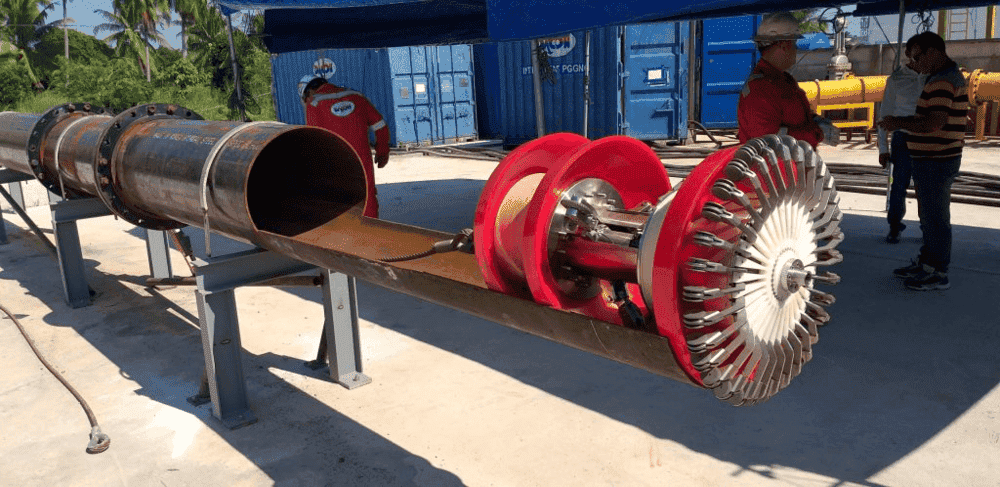

Oil pipelines use "pigs". That is a device that travels through the pipe to clean and/or inspect the inner walls. It occurs to me that it would also do a good job of flushing out any creatures trying to swim upstream. Send a pig through every few minutes.
OK, that device looks a lot like a jet turbine.
Coupled with the blurb "Send a pig through every few minutes", I had a vision of a gratuitously gory solution to the OP's problem. :eek:
It does look like that , but it is just pushed along by the liquid bring plumped.
Looks like wheels on the end of struts, not turbine blades. Wheels like off the bottom of an office chair. Turbine blades would be angled somehow, not just straight. Presumably it's designed to push off the walls on those wheels when it navigates bends and such. When it's just flowing along it presumably is fairly close to neutrally buoyant.
Yes.
