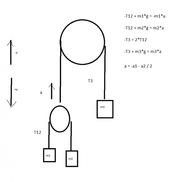

Sorry for the late response, here is my diagram,
  • #40
I think I made an error in the diagram, the negative sign is supposed to be on the opposite side (the left side) in equation 5. So the acceleration of the pulley should be -a pointing upwards.
  • #41
In the first two equations, you have the same acceleration for m1 and m2.
It is still not clear what your sign conventions are. The diagram has an up arrow marked -a and a downarrow marked +a, implying down is positive. But you have another up arrow marked a, which says the opposite.
Tensions are not quite the same as forces. Rather, a tension of a straight massless string is an equal and opposite pair of forces. Best is to consider them as forces exerted on the masses. With positive down, the mg terms all act positively, so the sum of forces on each mass should be of the form T+mg, not -T+mg or T-mg etc. Likewise, the resulting accelerations should all be of the form ma, not -ma.
In short, the basic form of Newton's law is ΣF=ma. Note there are no minus signs in there. You only need to introduce minus signs into it if you are using an inconsistent convention, such as gravity positive down, other accelerations positive up.
If you are not sure you have the signs right in an equation, think through how each term affects others. E.g. in your first equation, suppose the acceleration will turnout to have a positive value. That means (with your positive down convention) the acceleration will be downwards. Would increasing the value of g increase the downward acceleration or reduce it? Which way does your equation say it will work?

-My intended sign conventions are negative upwards, and positive downwards
-Do you mean that tensions are not quite the same as forces in the way like a normal force is to a force? I'm not sure what you mean by all masses should be of the form T+mg, if that was the case, then how would I distinguish one from the other? If mg is positive, then T is opposite- meaning it's -T.
-According to the first equation, I'll get a positive acceleration, which is inconsistent with my convention- so that's wrong.
Does this new equation for mass 1 look good?
m1g - t12 = m1a
I'll be getting a negative acceleration this time

The problem says that both pulleys rotate clockwise. The string around the upper pulley accelerates with A, the string round the lower pulley accelerates with B with respect to the pulley. The upward direction is taken positive. The tensions act all with positive forces on the blocks.
The acceleration with respect to the ground are
a3 = -A,
acceleration of the moving pulley is ap = A,
a1=A+B, a2=A-B.
Now the equations F=ma come.
m3a3=T3-m3g,
The moving pulley has zero mass, so
mpap=T3-2T12=0
m1a1=T12-m1g --> m1(A+B)=T12-m1g
m2a2=T12-m2g --> m1(A-B)=T12-m2g
Can you go on?

I've had an enormous battle to get Sho Kano to settle on a convention and stick to it. Sho Kano opted for positive down everywhere, so now I'm trying to get the equations to conform to that. Now you have posted equations using what I refer to as the naive convention of assigning positive directions independently for each force. This is only going to confuse matters totally.
  • #56
I deleted my previous post and changed to downward as positive.
The masses are connected to the strings, and the strings move on the rotating pulleys clockwise. A is the acceleration of the upper string, and B is the acceleration of the lower string with respect to the moving pulley, you can write the acceleration of the masses and that of the moving pulley in terms of A and B.
(a3=A, apulley=-A, a1=-(A+B), a2=B-A.The tensions act with upward forces on the masses, but T3 is upward and both T12 are downward on the moving pulley. Try to write your equations again.
