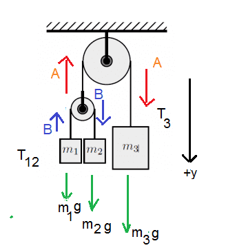

The masses are connected to the strings, and the strings move on the rotating pulleys clockwise. A is the acceleration of the upper string, and B is the acceleration of the lower string with respect to the moving pulley, you can write the acceleration of the masses and that of the moving pulley in terms of A and B.
(a3=A, apulley=-A, a1=-(A+B), a2=B-A.The tensions act with upward forces on the masses, but T3 is upward and both T12 are downward on the moving pulley. Try to write your equations again.
-T12 + m1g = m1a1
-T12 + m2g = m2a2
-T3 + 2T12 = 0
a1 = -A-B
a2 = -A+B
-2A = a1 + a2
A = -a3
2a3 = a1 + a2
-T3 + m3g = m3a3

Those equations are all correct if we take all accelerations as positive down but all tensions as positive up forces on the masses. So let's go with that.
Edit: sorry, there is still a sign error in the accelerations. I didn't notice, partly because it is in an equation that you previously had correct. See e.g. the last line of your post #45.

Use A and B in the equations instead of a1, a2, a3. Eliminate the T-s and solve for A and B. You get the accelerations from them. There will be no negative term in the denominator.

Sho Kano said:
A = -a3
No, a3=A

A is correct. Check the signs in the numerator for B. I got the opposite. I will check my derivation.

Remember, a3=A. See the picture in post #56
