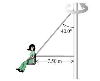

In another version of the "Giant Swing", the seat is connected to two cables as shown in the figure View Figure , one of which is horizontal. The seat swings in a horizontal circle at a rate of 33.1 rev/min
If the seat weighs 252 N and a 831 N person is sitting in it, find the tension in the horizontal cable.
If the seat weighs 252 N and a 831 N person is sitting in it, find the tension in the inclined cable.

Sorry, picture is now uploaded. :)

Rather than use some canned formula (what's that formula for, anyway?), start from first principles. Identify the forces acting on the "person+seat" and apply Newton's 2nd law. Analyze the vertical and horizontal components separately and then combine the two equations.
So the forces acting on the person+seat are the horizontal cable and the inclined cable, their weight (252 N and 831 N), and gravity. A period of 33.1 rev/min is given, once converted to seconds (60 sec/ 33.1 rev), you have for every one sec, 1.81 revolutions, or 1.81 rev/sec.
Using Newton's Second Law, the net force is equal to the product of the mass and acceleration of a given object. The net force is also divided into horizontal and vertical components. So the product of the mass and acceleration on the horizontal component and vertical component are treated like two separate coordinates. In this problem, there does not seem to be any vertical acceleration.
So to solve the net force on a given body, we need to know both the mass of the body in question, (which in this case is the weight of the person + seat), and its acceleration as it revolves.
The horizontal acceleration is toward the center of the circle. Since the acceleration I need to figure out is circular, in other words, a radial acceleration, the equation I used above is used to calculate the acceleration of a body moving in a uniform circular motion. I forgot to label everything, which would probably explain a lot more.

You are using [itex]a_c = \omega^2 r = 4 \pi^2 f^2 r[/itex]. Why did you multiply by sin(40)?

Draw yourself a diagram showing all the forces on the combined mass including their directions. Call the tensions T1 (inclined) and T2 (horizontal). What's the net force in the horizontal direction? Set that equal to ma.
What's the net force in the vertical direction? What must that equal?
You'll end up with two equations, which will allow you to solve for the two unknown tensions.

What matters in calculating the centripetal acceleration is the radius of the circular path. That radius is given as 7.5 m. No need for any trig.
That angle will come in handy later when you are analyzing the components of the tension from the inclined cable.
I've been doing it the other way around. The mass and acceleration seemed like they would be the first targets to solve, then the net force could be identified.The only other forces given are the weights of the two bodies. I'm not sure I follow you.
Treating the masses as one combined mass, there are 3 forces acting: Weight (acting down), tension 1 (acting along the incline), and tension 2 (acting horizontal). Find the horizontal and vertical components of these three forces.
The net force in the vertical direction should be equal to the weight of the two masses as there is no vertical acceleration. But since the bodies aren't moving in any vertical direction, shouldn't the total net force equal zero?
The net force in the vertical direction is the sum of the vertical components of all 3 forces. Add them up! Since there's no vertical acceleration, that sum must equal 0. That's one equation that you need.
To get the second equation, add up the horizontal components of all 3 forces. Since there is a horizontal acceleration, that sum must equal ma.

K, I went back to school, and got some feedback from my friends. Tell me if I did this right.
If we label the inclined cable as [tex]T_{2}[/tex], we solve for it first. This is done by adding the two weights as Newtons together, then dividing by the cos(40).
So,
(252N+831N)/cos(40)=1413.7 or 1414

And apparently [tex]T_{1}[/tex] must support the weight of both itself and [tex]T_{2}[/tex]. So you have, by calculating the sum of both forces, and setting it equal to the N we solved above, 9985.885N, the tension for [tex]T_{1}[/tex]. So laid out this should be what it looks like
9985.885N=[tex]T_{1}[/tex]+[tex]T_{2}[/tex]*sin(40)
9985.885N=[tex]T_{1}[/tex]+1414cos(40)
Solving for T, you get
9985.885-1414cos(40)=8902.698

Looks good. This is just applying Newton's 2nd law to the vertical direction:
[tex]\Sigma F_y = 0[/tex]
[tex]T_2 \cos(40) - W = 0[/tex]
[tex]T_2 = W/\cos(40)[/tex]
The way to look at it is using Newton's 2nd law again:
[tex]\Sigma F_x = ma_c[/tex]
[tex]T_2 \sin(40) + T_1 = ma_c[/tex]
[tex]T_1 = ma_c - T_2 \sin(40)[/tex]

Why did you change sin to cos?
Correct this.
I'm not sure if all the calculations or the theory is correct. The online homework program stated I was a little more than 100 off, but accepted my answer anyway. I'm not sure why, but curve me in the right direction with this problem, so I can ensure myself that I know what I'm doing is right, and why.
I only see one mistake.
Awesome. The answer I got from correcting the cos to sin, I resulted with 9077. The answer desired was 9050. Though it wasn't the exact number, it was a lot closer to the right answer than 8902 (which results in a 148 difference).
