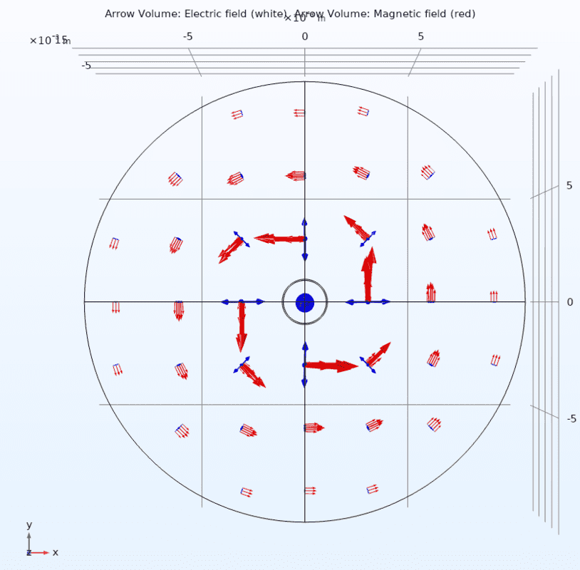

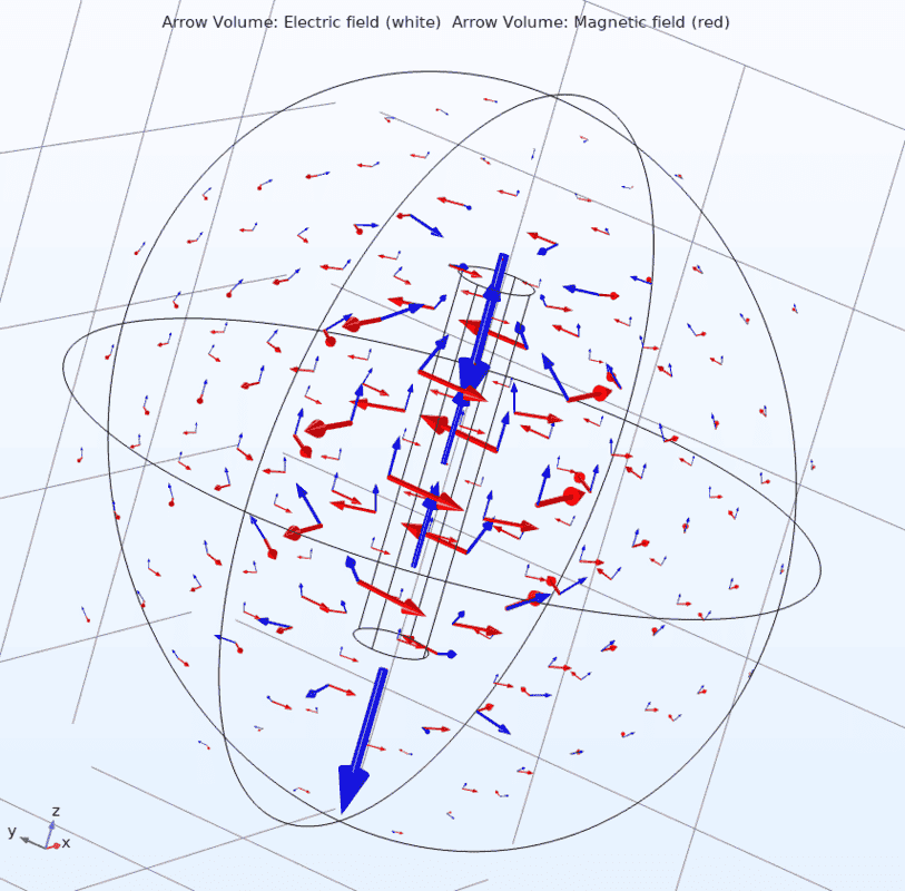

I made a simulation (comsol) of a piece of aluminum wire (r=1mm h=10mm) excited by 1A DC inside a sphere (r=10mm) of air. Here are the 3D plots:
Since I ever only have 'seen' E&M fields depicted in textbooks and never in real life, I'm a bit surprised by the simulation result, I would at least have expected the M field to be more uniform like the E field.
I would appreciate if the experienced experts could weigh in here, is that really how real E&M fields would look like? Or maybe my simulation is flawed somehow, that's always a possibility.

it looks pretty flawed. Your source is axisymmetric, so your fields should have axisymmetry also.
My thought exactly, I now believe somehow E&M fields may not be fully coupled in the chosen physics interface Magnetic and Electric Fields (mef) despite the documentation stating otherwise. So I split the physics up in two physics interfaces Electric Current (ec) and Magnetic Field (mf), and now the plot looks like in the textbooks:
The only slight drawback of two physics interfaces is that the wire needs to be excited for each physics interface i.e. two different ways but resulting in the same.

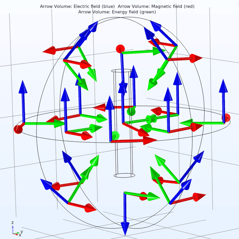

I'm just answering my own rhetorical question about how to calculate and plot the Poynting vector S when E and H is known. Maybe this has some interest from other comsol beginners like me, or maybe not.
It was actually simpler than I thought, you can simply calculate the cross product directly in the form field where you pick the values you want to plot.
And then the plot looks like below (all vectors are normalized). I note there are slight problems with vectors whose source point is on axis with the wire, but I believe this is a matter of a bit further tweaking.
