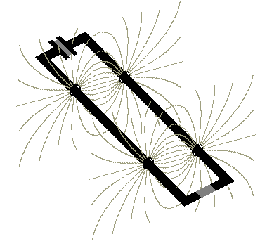

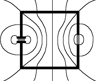

When looking at the E field in a circuit, we usually find something like the images below (from here).
Diagram of electric field lines around a thick-outlined square loop with a resistor-like bar on the left side and a shaded segment on the right side, with field lines curving outward on the outside and inward through the interior.
Diagram of electric field lines around a black rectangular loop circuit with three point charges marked as dots on its sides, and a grey resistor-like segment at the lower right corner.
This is with an idealized circuit, with idealized (0 resistance) wires linked by a resistor. I wonder what the same pictures would look like with real (non 0 resistance) wires?
I think it would be the same, except that now there would also be a E field inside the wires. Is this correct ?
However the pictures above do not show any E field inside the resistor, that seems strange to me.
I'm ignoring any transient state.
For typical setups: very similar. If the resistance of the wires is not small compared to the resistance of the resistor, the field lines are not orthogonal to the wires any more.
The magnetic field gets weaker everywhere if the overall resistance in the circuit increases, but its geometry does not change.
Probably just a drawing issue. You also don't see field lines in the power source.
Why is that?
Also, can you confirm that the E field lines inside the (non ideal) wires points in the same direction as the current does? Due to some buildup of charges during transient state from what I read.
DoobleD said:
Why is that?
You get a component along the wire from the electric field along the wire.
It does not, there is still the orthogonal component.
Is this component along the wire inside or outside the wire or both? And where does that component comes from?
Are you saying that an E field inside the wire tends to be parallel to it, while an E field outside tends to be orthogonal to it, so the addition of both make a net E field not quite orthogonal nor parallel, but kind of "tilted" ?

@DoobleD inside the wire the current t is in the same direction as the E field. Outside the wire there is no current.
DoobleD said:
Thanks. Why then is the outside field not orthogonal anymore? Is it somehow "influenced" by the straight field inside the wires?
What do you mean by "not orthogonal"? I am not sure what you are asking.
Well I'm reusing the term of mfb. I understand it as "not perpendicular". That would mean that the E field just outside the wires has a non zero component along the wire.
I might have misunderstood mfb answer.
I understand that there is no current outside of the wires. My concern is about the E field everywhere. We all agree the E field inside the wires is in the same direction as the current. What about the E field outside the wires?
DaleSpam said:
You might like this reference. It goes into considerable detail about the field lines inside and outside the wire.
http://depa.fquim.unam.mx/amyd/arch...ia_a_otros_elementos_de_un_circuito_20867.pdf
Thank you, that is exactly what I was looking for!
Reading it, as well as some other papers referenced on it, provided a lot of answers, not only regarding the E field behaviour but also energy flow and surface charges on wires. Actually you already gave me the link but I needed to learn about magnetic fields and the Poynting vector. Very nice. :)
