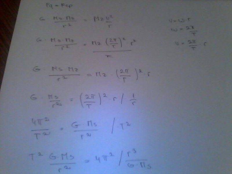

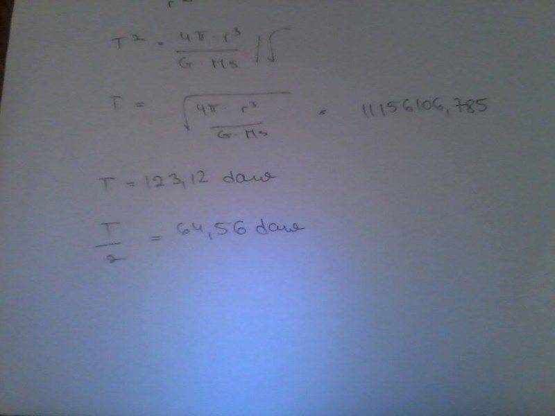

Well honestly I'm completely lost, and at this point totally desperate. I'm really not sure what to do. This is how I done it, but I'm not even sure it's the right way to go

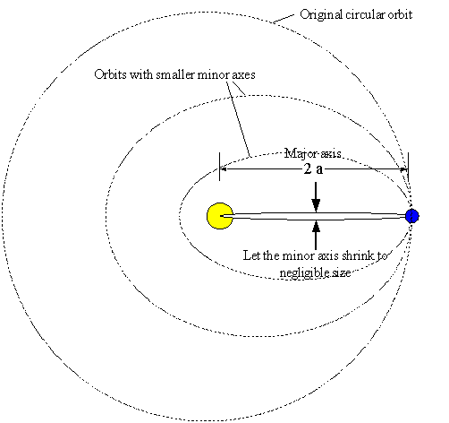

Sketch your "degenerate" orbit that's equivalent to the Earth plunging straight into the Sun. Effectively the semi-minor axis shrinks down to negligible width, while the perihelion distance becomes indistinguishable from the Sun's center.
Be sure to indicate the semi-major axis on your diagram!

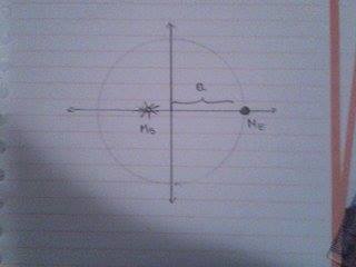

Can we see your sketch?
It's probably not complete.
Okay, that's incomplete as you say. What you want to do is consider an elliptical orbit where the temporarily "stationary" Earth is at the aphelion point. As the minor axis of the orbit is shrunk down to negligible size, the perihelion distance pulls closer to the Sun's center.
Note that the major axis of the orbit is 2a, where a is called the semi-major axis (half the major axis). For your "degenerate" orbit the whole major axis is the same size as the original orbit radius of the circular orbit.
So, what is the value of "a" for your problem?
ooooh it's r/2 or 1,496*10^11 m divided by 2
