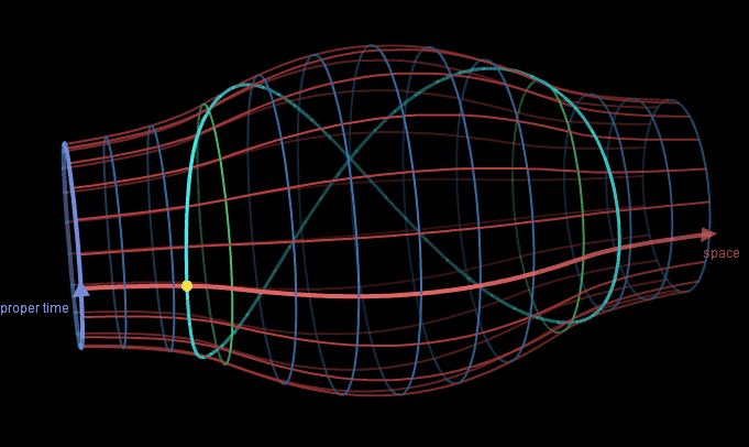

One way of visualizing this is to draw a space-time diagram on a curved surface. The "straight lines" (geodesics) on the curved surface don't stay a constant distance apart. For instance, if you draw "straight lines", curves of shortest distance, on the spatial surface of a sphere, they are great circles, and they don't stay a constant distance apart, but in fact intersect at some points, while they diverge at others.
People seem to be reluctant to draw space-time diagrams for some reason, but they're very helpful. One of the posters here, AT, has posted a rather nice diagram many man times, a 2d graphic showing 'straight lines' exhibiting geodesic deviation.

In curved space-time you have only locally inertial coordinates. The rest frame of the Earth is only inertial at the center, but not at the surface, where the geometry can be approximated as shown below:
Locally at the Earth's center the cone shown above would be a cylinder, so the apple would stay where it is. The get a transition between the cone at the surface, and the cylinder at the center and infinity, you must introduce curvature, as shown below:
