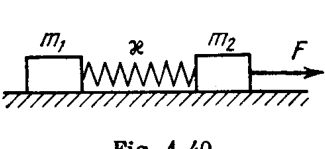

Diagram of two blocks labelled m1 and m2 on a horizontal surface, joined by a spring labelled k, with an arrow labelled F pulling m2 to the right; caption Fig. 4.60.
My solution:
The distance between the block is x2-x1.
x2'' = F/m2 - k(x2-x1)/m2
x1'' = k(x2-x1)/m1
x2''-x1'' = x''.
x'' = F/m2 - kx(1/m1 + 1/m2)
Being y = (1/m1 + 1/m2)
That is>
x = (lo - Fy/m2k)*cos(wt) + Fy/m2k
xmin = lo
xmáx = -lo + 2*F*y/(m2*k) = -lo + 2*m1*F/k(m1+m2)
But the answer to xmax is lo + 2*m1*F/k(m1+m2)
Do you see any error?
The way you used x1, x2 and x, you effectively defined these as though l0=0. That's fine so long as you remember to add l0 back right at the end. But somehow you got it as being multiplied by the cos term.

You use ##kx## for your force, but ##x## is the distance between the bars whilst ##x-l_0## is the extension! If you replace change your equations accordingly, you will get that the general solution is then $$x = A\cos`{(\omega t)} + \frac{F}{kym_2} + l_0$$ and you can deduce that ##A = -\frac{F}{kym_2}## with ##x(0) = l_0##, which then gives you the correct result.

I am saying that your solution was technically in error right at the start:
If the distance between the blocks is x2-x1 then the tension is k(x2-x1-l0).
If you redefine your x variables so as to exclude l0 then all your equations work, but when you solve the ODE there will be no l0.
Having solved it, and obtained the min and max values of x, you can add l0 back to get the min and max values of the separation.
