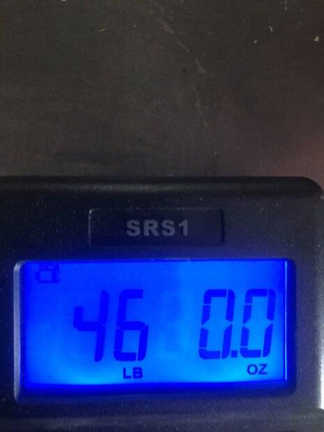

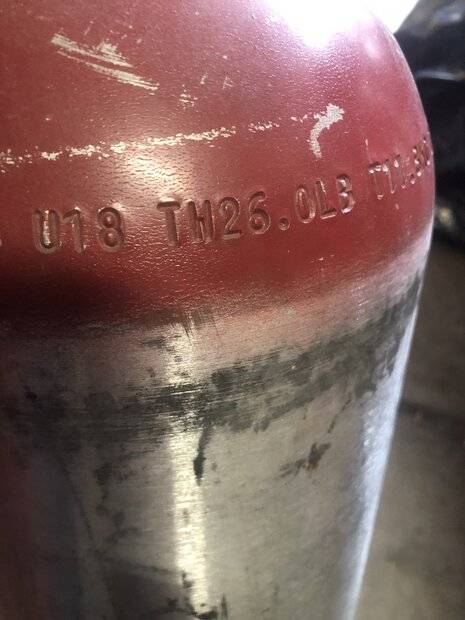

Weighed the two new 20-lb cylinders. First one was spot on 20-lbs net LCO2. Second was short by 1.7 ozs (only posted pics of 1st cylinder).
Some other notes: Local supplier didn’t have any ideas/recommendations for a LCO2 flow regulator. I told him a pressure regulator wouldn’t work anyway because we still need high pressure just at a lower, adjustable flow rate. Harris makes some flow regulators—use them in various welding processes—but I will have to contact it to be sure it would fit this tank [valve] style and is designed to be used safely with LCO2.
Supplier didn’t offer a blanket heater to keep tank warm, but pointed me to the web. Said the tank is rated for 1,800 PSI. He didn’t know the blow-off relief pressure, but said last summer a 5-lb released sitting in the sun on a hot day.😳 And once the relief pops, it empties.

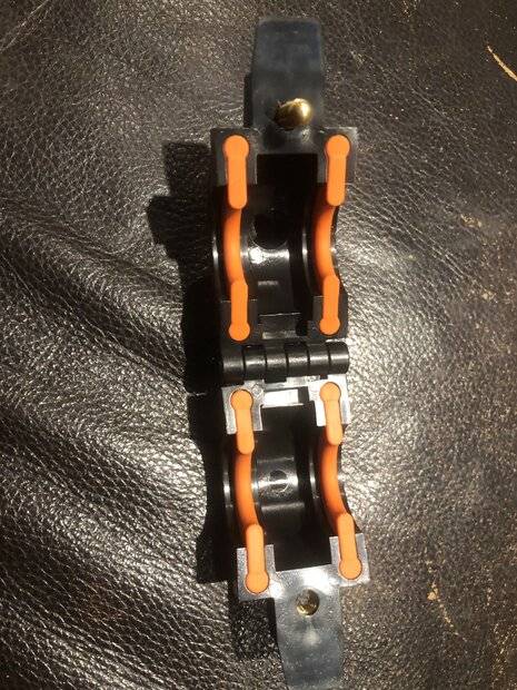

What you can’t see in the photo here are the orange, rubber-like seals inside the C-clamps that get squeezed around the pipe. These C-clamps (various sizes for various pipes) are first placed around pipe and then you tighten a bolt to close the rubber seals firmly on the pipe. This keeps the LCO2 somewhat regulated/contained to the effected area. The manufacturer designed it so it’s loose enough that pressure won’t build. In some cases, it’s fairly quiet (or at least for awhile) and then will suddenly pop open a minor stream here/there or even where you connect the hose adapter to the C-clamp.

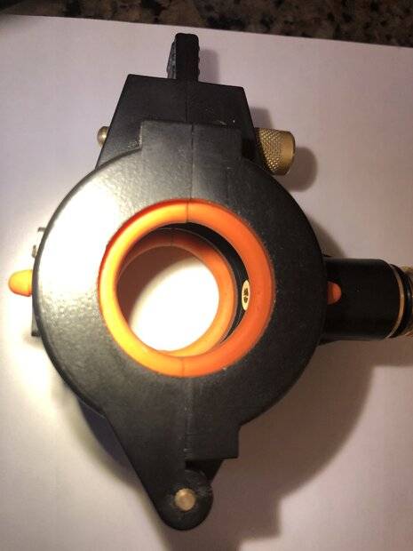

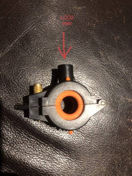

Looking at the “Freeze Head” (what I’ve been calling clamp) there is quite a bit of space (interstice) that does fill with dry ice. I measured the “Injector” (what I‘ve been calling the adapter) gap with some putty at approx 2.3mm or 3/32 in. From field observations of 3/4” CPVC (see pic), the freeze-effected zone appears to be approx two times the diameter of the pipe, so plug is approx 1-1/2” long x 3/4” diameter.From the manufacturer: “-110°F ice pack is strong enough to withstand 7,000-PSI (500 bar).”

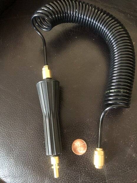

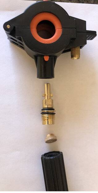

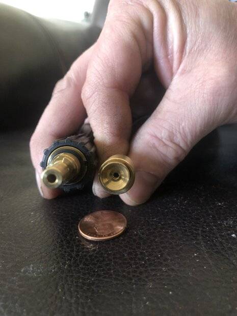

This week I called ColdShot tech support, and it is going to forward some of my high altitude questions/concerns to product engineers in UK. In the meantime, it suggested to try removing the second sintered brass filter in the head of the injector. Tech said it can clog or even freeze up causing problems. So I removed it (1) to inspect it and (2) evaluate next freeze performance without it. Surprisingly, it did have some sort of white contamination partially covering surface of filter. Looked like mineral residue; however putting some citric acid on it gave no reaction. Interestingly, upon disassembly and looking right after where LCO2 goes through second filter, it goes through a very tiny hole (see pic) before leaving the much larger diameter brass nozzle of the injector. In a pic, I stood up the two identical nozzles to show how small the hole is LCO2 enters and then much larger hole coming down the brass nozzle. Also, I included pic of what the interstice-filled space looks like after removing Freeze Head after a freeze. What I find fascinating is the dry ice outside the pipe is so light and fluffy vs. the super strong, dense ice inside the pipe.

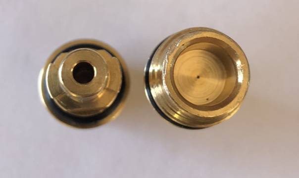

IMG_7644.jpeg Injector components (incl 2nd filter) and 3/4”-sized Freeze Head
IMG_7646.jpeg Injector nozzle different angles (big hole is outlet/smaller is inlet)
IMG_7648.jpeg Freeze Head with Injector inserted

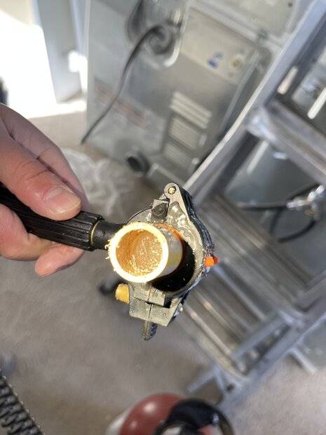

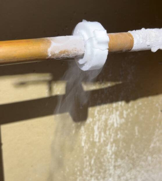

IMG_7652.jpeg Picture of dry ice on pipe after removing Freeze Head
IMG_4430.jpeg Cross-section of ice plug inside 3/4” CPVC
