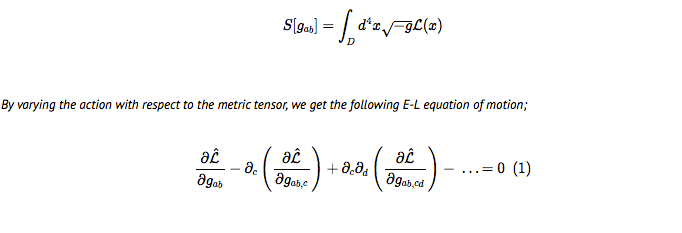

I have to admit that it is very remarkable derivation, but in the attachment I can not understand how the lagrangian takes such a weird form in terms of metric tensor ? I could not capture the logic...

That may take some investment on your part. There are quite a collection of GR books out there.

You are asking quite standard textbook material, so maybe you should consult a good textbook on GR. From there you can ask questions.
By the way, the attachment at post 10 is totally about the euler lagrange formula including second derivative of a variable (metric tensor in attachment). I consider it does not have to involve GR, just about lagrangian equation. But, I have to admit that I have never seen the second derivative concept of euler lagrangian formula. Also when it involves second derivative concept, there is a (-) sign. In short, Could you provide me with the second derivative concept of euler lagrangian formula or derivation of it ? I just know the proof of at most first derivative concept...
doesn't usually happen but conceptually it's identical to the usual case. No GR was evoked in the equation you posted which was an application of variational calculus. You might read up on that.
See e.g. Ortin's Gravity and Strings, or d'Inverno. You consider a lagrangian up to second order derivatives, vary it and use partial integration. This calculation can be found in the textbooks and explains the alternation of the signs. Try it also for yourself.
I suggest the following exercise. Consider a Lagrangian density (!) ##\mathcal{L}## which depends on one field ##\phi(x)## and its first AND second derivatives. The action is then written as
S = \int d^n x \mathcal{L} (\phi, \partial_a \phi, \partial_a \partial_b \phi)
The variation of the action is then
\delta S = \int d^n x \delta \mathcal{L}
The variation ##\delta \mathcal{L}## is
\delta \mathcal{L} = \frac{\partial \mathcal{L}}{\partial \phi} \delta\phi + \frac{\partial \mathcal{L}}{\partial (\partial_a \phi) } \delta (\partial_a \phi) + \frac{\partial \mathcal{L}}{\partial (\partial_a \partial_b \phi)} \delta (\partial_a\partial_b \phi)
Now you should write this, using partial integration, as
\delta \mathcal{L} = [EOM] \delta \phi + \partial_a B^a
where [EOM] are all the terms which multiply ## \delta \phi ## and hence will give the equations of motion (EOM), whereas ## B^a## is a boundary term which will vanish upon plugging into the action and using Stokes' theorem and your boundary conditions. You can use the fact that the variation and the partial derivatives commute, i.e.
\delta (\partial_a \phi) = \partial_a (\delta\phi)
(why?)

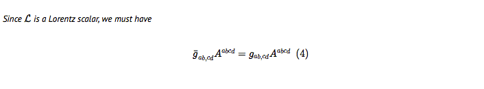

hi, I would like to express that when I look at the shared derivation ( called "this") in post 8, I can not understand the equation in my attachment. Could you explain this equation? Why are the metric tensors with partial derivatives equal in different coordinates?
mertcan said:
(((if you barely understand equation, you can look at my attachment... ))))
\bar g_{ab,cd} A^{abcd} = g_{ab,cd} A^{abcd}
Just add two hashes before and after for inline maths like ##x=1## or two dollars for maths on its own line like $$F=ma $$ Quote my post to see what I've done if you want. Your equation is
$$\bar g_{ab,cd} A^{abcd} = g_{ab,cd} A^{abcd}$$
hi, I would like to express that when I look at the shared derivation ( called "this") in post 8 and fourth equation of "this", I can not understand the equation below. Could you explain this equation? Why does the capital A remain same in the equation? ( I think it should not remain same, because it consists of metric tensors, and if we change the coordinates, metrics change and hence A will change )
