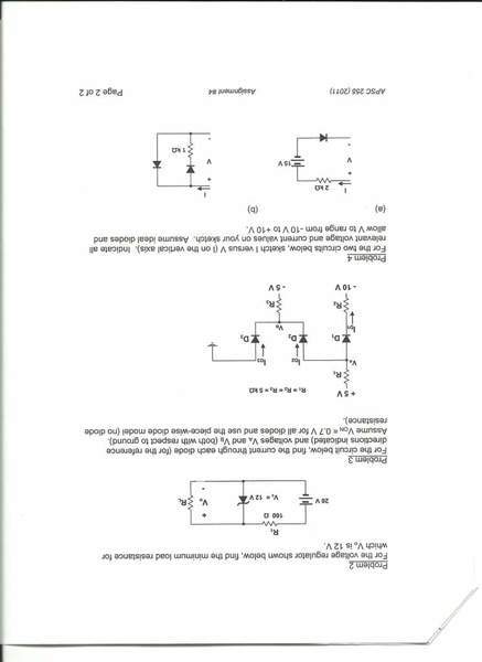

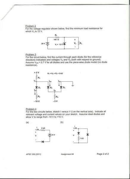

Hi I am having trouble figuring out what to do with negative reference voltages in my circuit. I attached my problem(Problem 3) and I know that some current will be drawn out of the ground and I think all of the diodes will be on but I am unsure how to approach this problem.

Sorry Here it is right side up
OK, you are right about the diodes all being on. You need to show some work here. What have you tried so far? Have you read the forum rules about how to post homework problems?
Yes I have read the rules regarding homework. So far I have redrawn the circuit with batteries in place of the diodes each = to 0.7 volts. The 0.7 V batteries all oppose their assigned current ( ie the negative end of the battery is the same side as the cathode on the diode.
So first I tried to figure out each node using KVL starting with Va. But quickly I have figured out this cannot work. So right now I am sort of suck because I am not sure if what I am trying to do is to get each negative potential voltage to zero or if I should somehow find a way to sum up the voltage sources.
Oh and the current from the +5 Voltage source across R1 is 1mA

You might want to check that assumption about the diodes all being forward biased.
Assume for a moment that D2 is not conducting. What would be VA? Compare it to VB.
Hm ... I worked the whole thing under that assumption and got good and consistent answers. Are you sure I need to redo it?
ok so I have Va=7.15V and the current on the left side = 1.43 mA
Vb= 4.3V and current right side = 0.86mA. But how do I know that I can make the assumption to turn D2 off?
Like with D2 off I get Va>Vb which would mean that my assumption would not turn D2 off.
Oh wait. Va should be >Vb so the assumption is correct. Thanks for your help. One last question: when choosing diodes to be on or off do you simply take your best guess or is there a more systematic approach?

Suppose that you remove D2 from the circuit (excise it... open circuit it). What would be the potential VA? What would be the potential VB? What's VA - VB?
Va-Vb would be 7.15-4.3 = 2.85V

Where would a 7.15V potential come from? The highest potential source I can see is +5V.
That would be the potential with respect to ground.
What would be the potential with respect to ground? All potentials are with respect to ground. The highest potential source (with respect to ground) shown in the circuit is +5V.
Ok I found Va by (R1/R1+R2)*(5-(-100-0.7) = 7.15V since the bottom of the left side is -10. Likewise for Vb i found 0-0.7-(-5) = 4.3 V
