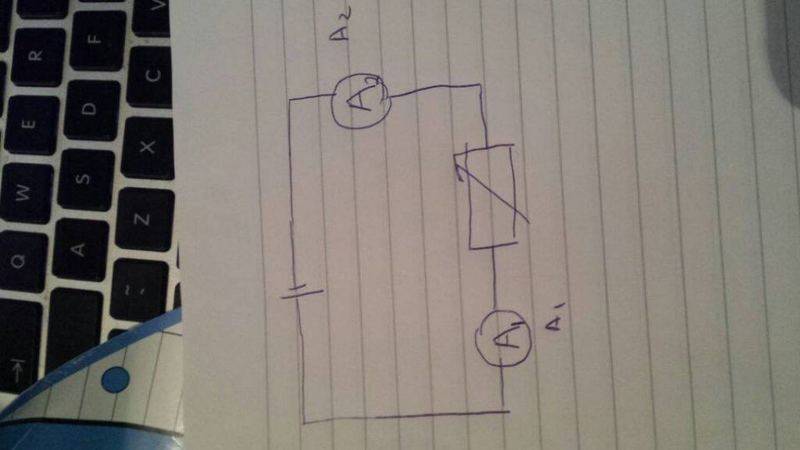

Hand-drawn circuit schematic, rotated sideways, showing a cell connected in series with ammeter A2, a variable resistor, and ammeter A1 in a single loop.
But will the current be different if it has gone through the variable resistor.

Handwritten circuit schematic on lined paper: a battery connected in series with ammeter A2, a variable resistor, and ammeter A1, forming a single loop.
Will the current reading on A1 be different to A2, the function of the resistor is to decrease the current so for this to happen, doesn't the current need to flow through the resistor?
In that circuit, the current is the same everywhere. Increase the resistance and the current decreases everywhere.
you have a slightly incorrect view of the concept, the other responders haven't picked up on this
The resistance doesn't decrease the flow of current. It only allows a certain amount of current to flow according to the value of the resistor and the voltage across it according to Ohms Law ... I = V / R
look at it this way ... a common misconception ...
A person asks ... I have a 12V 10A power supply, can I use it to power my 12V 1A project ? will it burn it out?
The answer is no
The load resistance of the project determines the current that will flow in the circuit
They then ask " what happens to the other 9A?"
Nothing, those other 9A are not generated in the power supply
Just because a PSU is rated at 10A, doesn't mean it's pushing out 10A all the time
That is just a maximum it can produce before it overheats and dies
The amount of current that leaves the PSU is set by the load resistanceDave
