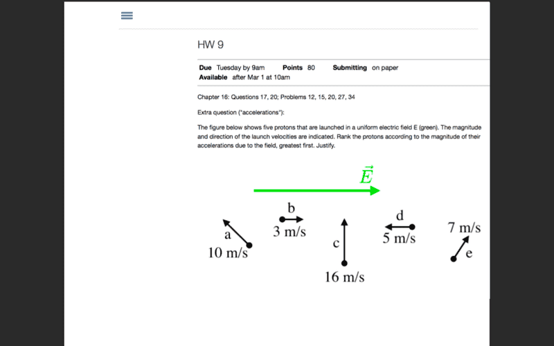

The figure below shows five protons that are launched in a uniform electric field E (green). The magnitude and direction of the launch velocities are indicated. Rank the protons according to the magnitude of their accelerations due to the field, greatest first. Justify.

Hi Philip KP. Welcome to Physics Forums.
You can upload various formats of image files such as jpeg or giff and insert them as full images in the body of your post (see the options next to the individual image icon associated with the attached file).
For your posted problem, what determines the magnitude of the acceleration of a charge in an electric field? Does the formula depend on velocity?

Welcome to the PF.
Hmm, that's a pretty confusing question (at least for me). The acceleration in a uniform E field is independent of any initial velocity. It just depends on the magnitude and direction of the E-field, and the charge and mass of the object.
You've correctly re-stated the problem, so I'm not sure what they are really asking. The velocities will certainly be different as the protons are accelerated by the field, but their accelerations will be the same. Maybe try answering the question about ranking their velocities, and see if that might be what they are asking. Can you submit your answer electronically to see if it's right? How many tries do you have?

So it might indeed be a trick question. Since you are handing in the paper version, you could say "they all have the same acceleration in the uniform E-field" and explain why. Then rank their velocities versus time just in case that's what they meant to ask...

Yes. And so what would the resulting acceleration be? :smile:
F=ma=Q x E?
m(same for all protons) x a(what we need to find) = [ Q(which is same for all protons) x E (which is uniform)]

There is no magnetic B field specified in this problem...
This looks correct to me. :smile:
Philip KP said:
Since F=Q x E but E is uniform does that mean F=Q??
"uniform" means that it is constant in magnitude and direction everywhere (or at least over the region of interest). You can't drop a term from an equation just because it's constant; at the very least it will "break" the units. A force (Newtons) is not the same as a charge (Coulombs), just as a force is not an acceleration; the "m" is required in the equation F = m⋅a, otherwise you don't have an equation.

You don't need to find a particular value for the force. You just need to find an expression for it, and note what values it depends on, and whether or not any of them differ from case to another in your problem.

That's why you need to write an expression for the acceleration, so you can test your assumptions.
So like Acceleration,=? meters/s^2 Q=1.6x10^-19 C, m=1.67x10^-27kg, E=? N/C, F=? Newtons,
a=F/m
F= QxE
a=(QxE)/m
Only problem is there is nothing about direction or velocity

That's not a problem, it's a bonus and a clear result! You now now that the acceleration does not depend upon direction or speed or distance; It only depends on the charge, the mass, and the electric field. So what can you conclude for the different cases presented?
